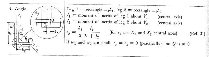

Your section may be too thick for this but does this help?
Derivation of Shear Center Q for "L" shaped section (from Roark's)

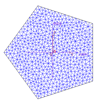

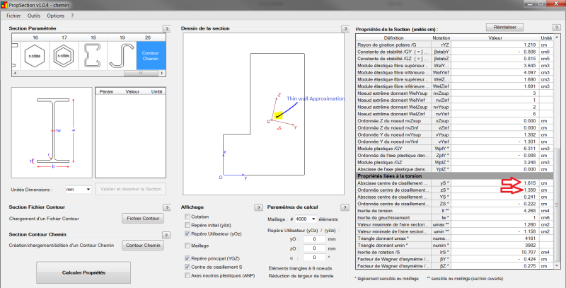

The easiest way to approach this is using numerical methods. Take a look at CTICM's software for the calculation of section properties:
PropSection

And also, JAE and haynewp I believe those methods assume that the shear stress is constant across the thickness of each wall segment, which is only accurate for thin wall structures :/
No worries though, it seems that there's just no quick way to go about it by hand!

If anyone was curious, using avscorreia's program...
Actual Shear Center
(16.15, 13.59)
compare with shear center = centroid
(14.29, 16.29)
SRSS error = 3.27
thin wall approximation
(15.5, 16.71)
SRSS error= 3.19
Looks like neither are a great approximation for thick objects, but neither are horrible either.

I believe it makes a finite element mesh of triangular elements, then numerically solves for the properties.
