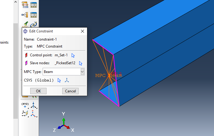

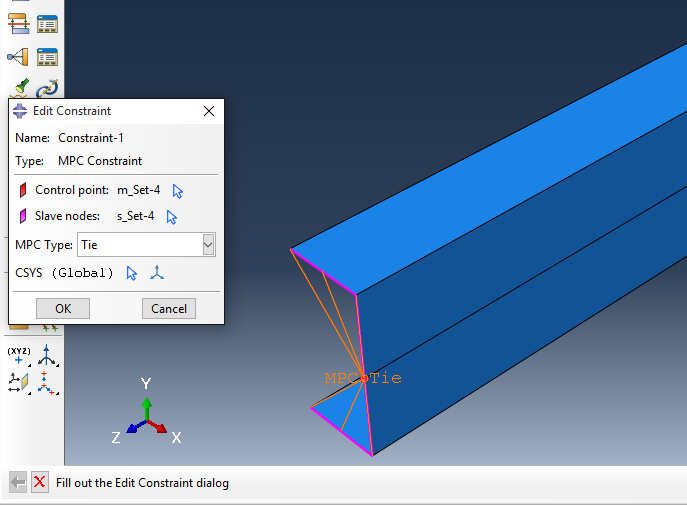

How can I consider the condition uz = const for the analysis of a column, as shown in the image.
I am performing analysis of composite materials columns!
From already thank you very much for your help.

Presumably you want the free edge to remain planar in the Z direction as it distorts. Just link all the nodes on that edge to a single node on that edge in the Z direction using *equation.

I used to add constraint MPC, would it? But still I did not get the expected results.
RE: ABAQUS- DOUBT - Boundary Condition
I tried these two forms
