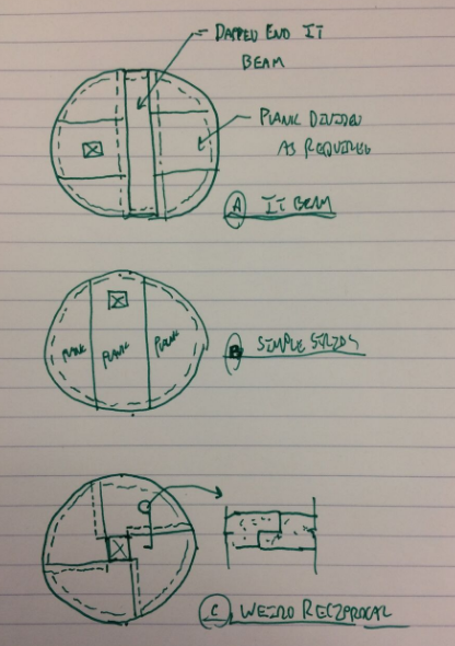

Got an interesting job and I'm interested if anyone has any good concepts on how to approach this.
Client has a 40 ft diameter concrete tank with an arched steel dome over it and is looking to replace the dome. The cover has to take large snow loads (~70 PSF ground snow) plus pedestrian loads. They got a price for an aluminum dome and it's fairly high so they're shopping around for alternative support structures.
So, I'm trying to come up with clever ways to do a precast structure that can be cost effective. We have a prestressing bed for slabs and small beams but it's limited to 18" depth. Any precast structural system ideas you folks think I should look at?
This is sort of the concept I was most leaning towards:

What have you got in mind for waterproofing the lid (assuming that's required)?
Is it necessary to create a positive drainage slope within the precast?
I've sketched a few options below. Your alternative would likely be preferable with respect to shipping, erection, and ease of drainage slope creation. Pretty much everything really. That said, you indicated that you wanted some options. I take that to mean more than one.

I looked at simple span slabs and it would be too expensive to ship. Your idea of a dapped beam could work, plus it doesn't all have to be precast. I could see a galvanized steel truss or something similar being acceptable down the middle and then precast panels spanning up to that. Thinking out loud though; anything that doesn't involved repetition always costs more with precast so I'd like to keep it as repetitive as possible.
Lastly, your "weird" slab panel idea looks crazy awesome. While I'd love to build it I have no idea how we would get these down the road without making every commuter in the state hate us. Though... do you have a CH-47 Chinook laying around I could borrow? :P

The weird panel scheme will erect like an Escher staircase. I would do this one just to (play) with the Contractor.

Years back, we did a steel tank roof where a consultant had designed and detailed the entire structure. It was about double the cost of what a normal steel tank roof structure would have cost. The lesson learned is that in construction, you gain a lot of efficiency from repetition and familiarity. So you can come up with all sorts of goofy ideas, and if somebody was accustomed to doing it like that all the time, it might work great and be done at a reasonable price. But if it's the first time for somebody to build it like that, you'll pay through the nose. New and different is great if you have deep pockets. "Playing with the contractor" is expensive.
"do you have a CH-47 Chinook laying around I could borrow? :P "
I actually checked into this years ago. The local helicopter company had about a 5,000 lb limit on their machine. To lift anything heavier, they had to fly a helicopter down from Kansas City, and that would run around $50,000 if I remember right. But the major obstacle was that they weren't allowed to lift a load and then carry it over people, so you couldn't just pick up an arbitrary (oversized) load and fly it to the far side of the metroplex.

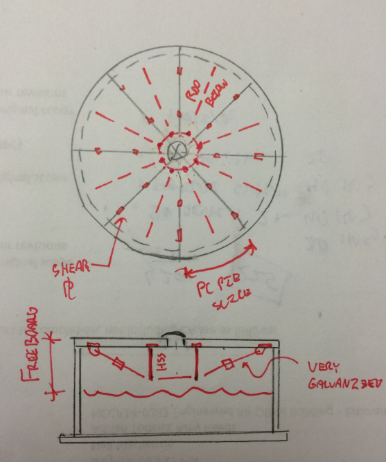

Are you going with the pie slices on a central column then? Is there already something robust upon which to install the column? I would expect so.
RE: 40 foot round tank cover ideas
Well this is all at the preliminary, cost-estimate stage so I suspect we'll have some details ironed out down the road. For now I'm assuming I can saw-cut out a section of the bottom of the tank and cast a footing into the tank. Either that or install a footing directly on the bottom of the tank pinned into the bottom. If these aren't realistic when we get into it then this could be an issue but is probably beyond the concerns of this stage.
As for the pie slices, that appears to be the way to go right now. It's doable in precast, ship-able, cost effective, wont be the hardest thing to set, and should go very quick once we've finished fabrication. Only other thing I think that could derail this is if the tank walls/foundation can't support the panels weight.

Always good to come to the table with more than one option. Of course an all steel option would likely be preferable once durability has been sacrificed by introducing any steel. The proposed system could be pitched quite easily if one could sort out the tapered bearing situation.
That could work. I've worked with similar setups for wood timber trusses in old mills. Haven't tried that sort of configuration in a circular pattern but no reason it couldn't work. The only downside I see is if you ever had to remove a panel or if someone overloaded it there's limited redundancy. Plus it cuts into your capacity a lot which might not be favorable.
"Very galvanized", hah! I don't know when but I'm going to get those exact words on a drawing one day.
