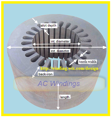

Sometimes, when the motor core has a "reserve", there is a possibility for new winding with higher power at same core.
In order to check, the main measures of the stator core and a photo of nameplate should be known.
Winding Repair and Design
