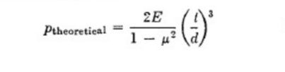

I am designing a glass vacuum chamber to work with 0.001 Pa for a sputter coater.
The method I found is Von Mises equation for thin-walled cylinder buckling. More precisely, I am following this paper:
"Prediction of vacuum-induced buckling pressures of thin-walled cylinders".
My parameters are:
E = 7.00E+10 Young's modulus for glass (Pa or N/m)
u = 0.2 Poisson's ratio for glass
r = 0.15 Inner radius (m)
t = 1.00E-03 Thickness (m)
l = 0.5 Length (m)
n = 6
Outside pressure= 1.01E+05 Pa (1 atm)
Inside pressure = 1.00E-03 Pa
Dif. pressure = 1.01E+05 Pa
The solution I found is: Critical pressure = 1.24E+07 Pa
This does not make sense since a glass only 1mm thick should not be able to handle all this pressure. Especially a piece so large.
I need to find the correct glass thickness.
Does anyone have a clue? What am I doing wrong?
Any help will be highly appreciated!

The introduction to the paper you linked to explains why you should not be designing using Von Mises equation. Next, look at pressure vessel design, where full vacuum ratings are common.

Thank you, man! I tried your advice on using the paper's data as input and found my mistake (Excel should not be used for this).
Now I got 1.2 mm as the minimum thickness for 10-3 Pa. So I intend to use 5 or 6 mm. What makes sense now.
mbt22,
Sorry, I didn't get why Von Mises equation should not be used in this case. The paper's introduction shows discrepancies on other studies but the paper's analytical part itself is based on the Von Mises formula. The results they found using it are not too far the experimental one, considering the precision I need for my vacuum chamber.
My cylinder is short and thin enough to fit on the Von Mises formula, but I am not an expert on this.
The main difference I found is the material, steel x glass. But I am assuming this is not a reason for not using the same method. Am I wrong?

BigInch, thank you! You are right. So I have to use another method. Von Mises is not applicable to glass.
Most books I found so far shows the stress in thin-walled cylinder as:
s = p * r / t
s = stress
p = pressure
r = cylinder radius
t = wall thickness
They say the formula is the same for external or internal pressure.
But I assume the strength for internal pressure is tensile and for external pressure is compressive.
Glass compressive strength is 10^9 Pa.
Using my data...
10^9 = 10^5 * 0.15 / t
t = 1.5 x 10^-5 m
This doesn't make any sense. What is wrong here?
Does anyone has any reference on calculating a "brittle material thin-walled cylinder subject to external pressure", please?
Thank you!

Stress is NOT the important consideration for external pressure. The failure mode is buckling. The important consideration for brittle material is the minimum design margin against buckling failure.
Note that out-of-roundess tolerances are critical for buckling assessments.

I found new references. Both uses the same method (NOT Von Mises since glass is a brittle material and NOT stress since the collapse is due to buckling)
- Process Equipment Design - Lloyd E. Brownell, Edwin H. Young. John Wiley & Sons, Inc. (Chapter 8)
This paper makes a lot of sense too, since the project is using a brittle cylinder under external pressure.
- New Ceramic Pressure Hull Design for Deep Water Applications - Shinichi Takagawa, University of Tokyo - IEEE 2010.
Right track now?
Thanks for the comments and help! All of them were very useful to me.

Top and bottom closed, or in other words a cylinder with closed ends develops longitudinal stress in additional to radial stress.
RE: Thin-walled cylinder under pressure
Quote (BigInch)
Good point! But by what I read so far the longitudinal stress is half the hoop stress. So thickness calculated for hoop will cover longitudinal as well.
Not necessarily so for buckling.
What if you were to design this thing using the rules in ASME Section VIII, Division 1?

Stresses are not separate. Principal stresses are combined according to the various stress theories to get the maximum shear stress.
