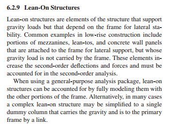

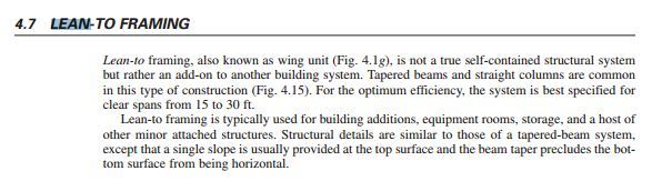

Both of these references deal with lean-to systems to a minor degree.
AISC Design Guide
Metal Building Systems - Newman
I don't know of a specific, extensive design guide tailored specifically to lean-to additions. We have some very experienced PEMB folks here at eng-tips however (Not me). Hopefully one of them will prove me wrong. I would expect that the general principles that govern the primary PEMB structure design would probably be able to see you through the lean-to addition design.

Lean-to frames are generally pinned to the main building column, particularly if they attach at some location other than the eave. (See attached detail) Proper design of stiffeners, bearing at the bolts, flange/web weld design (if the main building column is 3-Plate or PEMB construction), etc. is critical because you don't want loads from the lean-to affecting your main building at this localized position. Generally the lean-to takes only vertical loads and loads perpendicular to the building frames. Lateral loads parallel to the frames will be transmitted into the main building. For wind loads, this is for the most part simply a repositioning of the existing loads on that building from being uniform up the wall surface to acting 1/2 at the connection point between lean-to and main building and 1/2 at the base of the lean-to column. Longitudinal loads (perpendicular to the building frames will require bracing in the lean-to for that purpose.
The lower connection between the lean-to column and the lean-to rafter also is generally pinned to facilitate easy analysis. Fixing this location, which can be done for longer lean-to spans, creates a complex analysis problem as the designer needs to know the relative stiffness of both the lean-to structure and the main structure to properly distribute the lateral loads.
Where either the main building column or its foundation is inadequate to carry the lean-to vertical loads, an additional high-side column may be framed under the lean-to rafter at the main building to remove that load from the main building. This column may also be beneficial if the wind bracing at that column line in the main building is inadequate to carry the additional lean-to longitudinal wind forces, as a new set of bracing can be added between the lean-to columns in that plane.
Increasing the span from 24' to 58' is going to jump your moment in the rafter by almost 6 times (assuming a simple span rafter). This is likely more than you could accommodate by simple reinforcement of the existing beam in any cost-effective manner.
