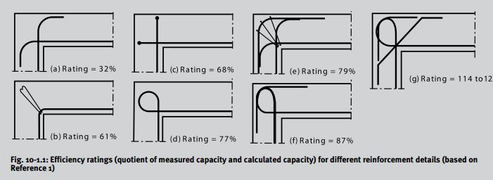

I've been working through some retaining wall details for a project that requires a condition with a footing without a toe and a footing without a heel. I'm curious on how others detail the wall to footing joint.
For a T-shaped footing, I typically detail per the CRSI manual, developing the toe bars and extending up into the stem. I will often omit the diagonal for shorter walls. If the toe is too short to fully develop, I hook the "O" bar.
For the L-shaped footing, when there is no toe and only one curtain of reinforcing in the stem, I'm looking at the best way to detail to fully develop the joint moment at the corner.The "O" bars would need to turn the other direction into the bottom of the heel in order to develop. Since the heel bars can't develop into a toe, my inclination is to turn them upward and develop into the wall.
I've been looking at some of the plan corner detailing conditions shown in Concrete International's detailing corner.

1) For serious toeless walls, I'll do something like G but using U-bars lapped with the flexural bars.
2) For minor toeless walls, I'll do the same as #1 but, instead of the diagonal bars, I'll bump the flexural bar up 15% more than required.
3) For heel-less walls, I'll check the lapped starter dowel in the corner using a curved bar node strut and tie model. For larger bars, this sometimes requires using a non-standard bend radius.

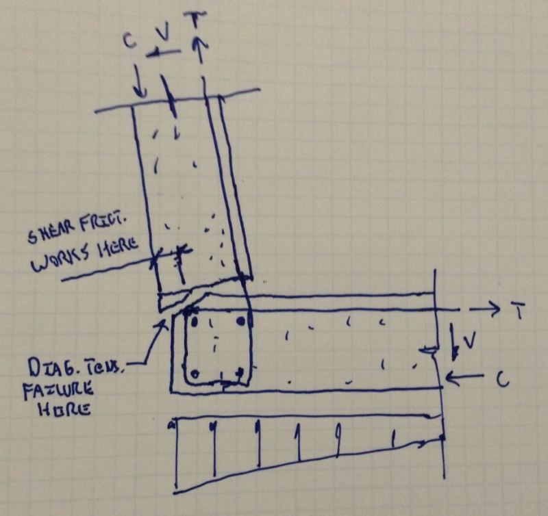

Toeless systems also have a rather serious stem to footing shear delivery problem that is not addressed by the joint flexural efficiency ratings. For that reason, the use of small diameter U-bars and/or the D bars is important.
Koot, I was also interested in your statement about shear.
Are you talking about shear friction at the joint, typical beam shear?
Does meeting the provisions for shear friction not adequately address the situation in a toeless footing?

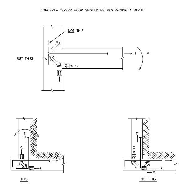

- In practice, my experience has been that most designers either do not design the connection at all or design it as you've proposed with one exception: you've got the hook on your stem bars facing very much the wrong way. Anticipated compression struts should always come into the concave side of hooks.
No, not in my opinion. They key to this, I believe, is to recognize that wherever you might check shear friction, there is also a complementary diagonal tension failure mode that needs to be prevented. Take a look at the sketch below and let me know if the issue doesn't pop out at you when considered this way. With toe-less retaining wall connections, it's especially bad because the flexural bars tend to be quite large and when the real world geometries of their bends are considered, you often find that no rebar crosses into that little wedge of concrete that wants to pull away.

The diagonal tension failure due to shear friction does seem to make sense for the toeless footing.
Do you have any suggested detail to deal with this potential failure plane, some additional feel good bars?
I am also a little confused by your dimension string "shear friction works here" over a small extent of the joint. Are you implying that shear friction only works where the compression block is located? Whenever I designed for shear friction I always assumed that shear friction worked full length of the plane (full width of wall) and that the bars prevented slip past the concrete joint that enabled a region carrying tension to also resist shear.
Also, I guess I do not see how the diagonal tension failure plane would apply in a regular retaining wall foundation with a toe though. I'm going to have to think about it.

Yes. As I mentioned above, I'll take one of two routes:
1) If the scale of the wall is such that the rebar can be #5 or smaller, I'll make it # 5 or smaller and not worry about it. I do this in combination with longitudinal bars in the bends of the flexural rebar. We seem willing to count on this as development for beam stirrups so I feel okay about it here.
2) For larger scale walls, I include the diagonal "D" bars as shown in the CRSI manuals and discussed in the other thread.
Quote (SNT)
Precisely. The reason that you can double dip with your flexural tension and shear friction reinforcing is that, under flexure, the balancing compression in the compression block effectively becomes the shear friction area. This is especially true in a situation like this one where the shear friction joint is a cold joint that is effectively pre-cracked and not particularly rough. Regardless of the code provisions, it seems self evident that the lions share of the shear transfer can be expected to take place where internal compression resides.
It wouldn't. That same shear would instead get dragged into the footing top bars and back across the heel to ultimately be resisted via friction at the soil/footing interface (depending on how you elect to resist shear in your retaining walls).
Do you have any reading on this? I have never heard of this before. I can't quite think of anything logical either that would make a strut better running into the concave side of a hook.

Oddly, I can't think of anything "official" that might sate your appetite for definitive reading. No codes, no hot-shot academic text books... What I can produce is a snippet from the design guideline of a well regarded concrete design firm. It's been so long since I've looked at this that I'd forgotten that it actually covers your very case.
Quote (SNT)
If you imagine the stresses that will develop along a hook developed bar in tension, you will come to the conclusion that there is a compression field (strut) emanating out from the concave side of the hook. As illustrated in the sketches below, you can either:
1) Have the hook direct that compression to a strut and/or tie restrained node that can resist it or;
2) Have the hook direct that compression off into no-man's land where you're counting on concrete in tension (anchorage type stuff) to keep the compression strut from blowing out.
I'm sure that you'll agree that #1 is much better even if it is not explicitly code mandated.

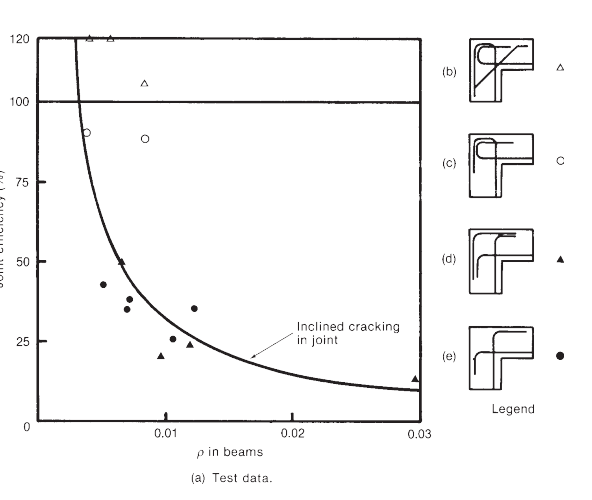

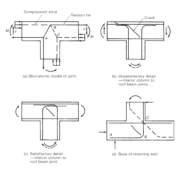

The Wight and MacGregor concrete book gives a really good explanation on the direction of hooks in chapter 17, Section 17-12, not directly in regards to retaining wall, but with regard to Beam-Column Joints. It goes into opening and closing corner joints, and (it does reference retaining walls in the t-joints) and shows the efficiency of each joint type. I came across it after posting the initial thread topic, it gave a really good breakdown of each joint condition along with an accompanying strut and tie representation that mimics what Kootk shows above. It also shows tested efficiency of each joint type. It explicitly references the turning of the dowels inward vs outward pointing dowels at a t-joint and the diagonal crack that develops. The results for turning the dowels outward away from the compression node, not good.
RE: L-shaped Retaining Wall (no toe) and "J"-shaped retaining wall (no heel) joint detailing
Here are some snippets from the work that msdmoney kindly referenced.
