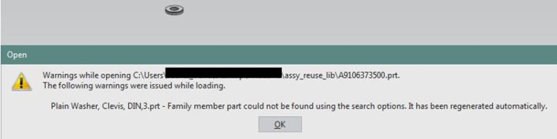

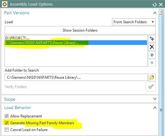

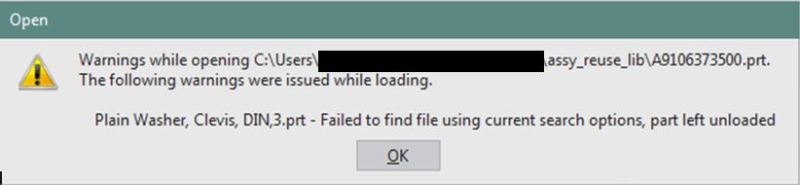

I open the same assembly from another computer. I don´t have access to this folder. But we are using the same Reuse Library. So I modify assembly load options as you can see below:
If I don´t set "Generate missing part family members" the next error occurs:
If I set "Generate missing part family members" NX display the next message and the washer appears:
My only complaint is that I have to change my load options and it doesn´t work with As saved.
