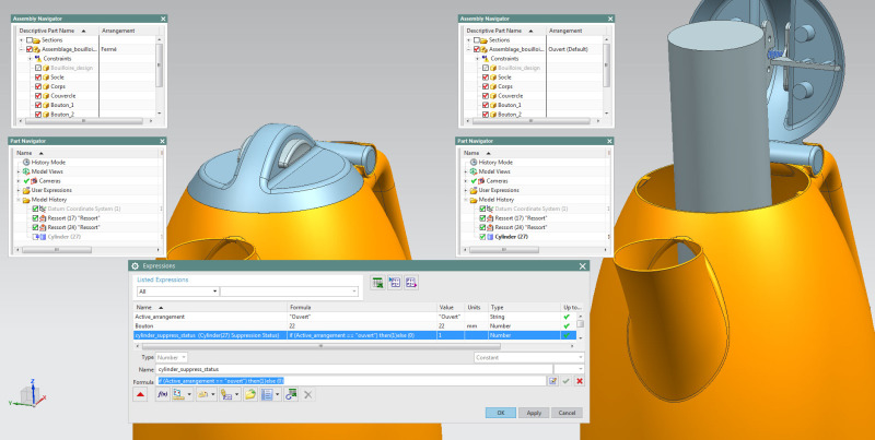

I know we can suppress a component in arrangements, but Can we suppress a feature made in assembly mode while switching arrangements?
NX9

Is your feature in the top assembly part ?

There is no way to check the active arrangement
So, jpetach has created the attached code for me in 2013: http://www.eng-tips.com/viewthread.cfm?qid=337317
It will create an expression "Active_arrangement" equal to the active arrangement.
Then you can suppress a feature by expression
Have a look the following example
Be careful that you need tu run the journal to update the expression
