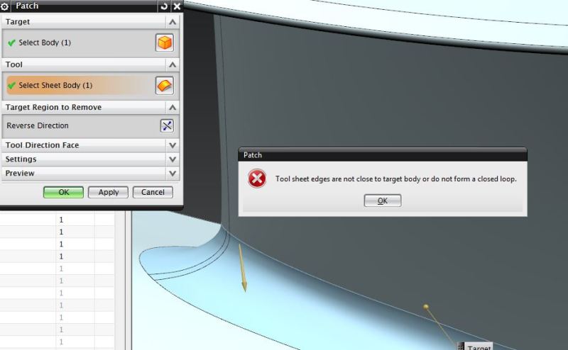

hi,
As you see in the above image, the fillet area is created by through curve mesh feature. The surface is tangent to the above and bottom surface. Now when i patch this surface with the solid, the above error comes. I am not able to analyse why this error came, since it is closed loop. Kindly help.

Have you tried reversing the direction of the target region and/or the tool direction?

When you run the patch feature, all outer edges of the tool sheet must lie on the target body, it must be water tight.
The patch feature has a patching tolerance, increasing this will make the feature do the job, but if you need a large tolerance , there will be an gap the size of the tolerance in the resulting model where the tolerance applies. In NX perspective, the edges does meet, within the tolerance.
If this does the trick, you can try go back to the curve mesh and tighten that tolerance and then keep the patch tolerance.
