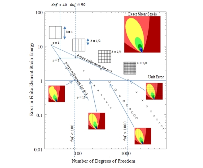

A finite element model approximates the solution to a real problem. If the stress/strain field for the real problem is constant then both elements will give the correct and exact answer to the problem. In general, however, the true stress/strain field will not be constant and will more likely be rather non-linear - think of a beam in bending for example. In this case the elements cannot model the true solution and the engineer needs to use mesh refinement to converge towards the true solution - think of approximating a general curve with piecewise constant functions, the more elements you use the more accurate will be your solution.
The same situation applies to the higher-order elements with the quadrilateral element having two additional nodes which give a slightly better potential approximation of the true stress/strain field.
Thus, I would say that there is no particular concern with using triangles rather than quadrilaterals. The reason that triangles are used more often is that the mesh is generated automatically and it is easier to generate triangles than quadrilaterals. If the mesh is to be generated by hand then I would generally attempt to do it using quadrilaterals since there is the small advantage noted above and it is also easier to perform uniform mesh refinement of the sort required in convergence studies.
I would also point out that unless there is any indication to the contrary, then higher order elements should be used. These adopt a higher order displacement field and in terms of computational efficiency perform significantly better than their lower order equivalents:
