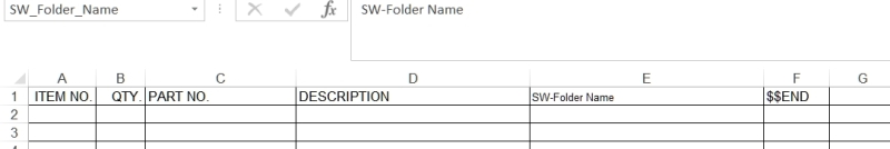

Trying to find out how to edit the excel bom template to include a column for Solidworks folder name so that I can keep track of the locations of all parts in an assembly (w/out opening SW). What needs to be typed in the Name Box in Excel to get this to work? For example, for part numbers you have to have partno in Name Box, however I'm not sure where this is pulled from in solidworks - my part number in properties is PartNumber

Here's a solution using Custom Properties.
Edit List on Property tab.
Add SWFolderName.
In Value/Text Expression add - $PRP:"SW-Folder Name" . (if you can find a way to add this to the list it would be a big help)
The Evaluated Value should show your file path.
Make a copy of the BOM that you want to change in Excel and rename.
Add a column in the appropriate place to the left of $$END.
At the top of the column type in your header.
Click on this cell, go to the Formulas ribbon, click on Define Name.
Type SWFolderName (no spaces or hyphens)

felix7502, this may work, it would still require me going through all my parts/assemblies and updating the custom properties to show the folder path. The native SW BOM uses windows folder locations of the part to populate the BOM. That is what I was hoping to include in my Excel version.

I think you could write a macro to update Properties. Good luck with your quest.
