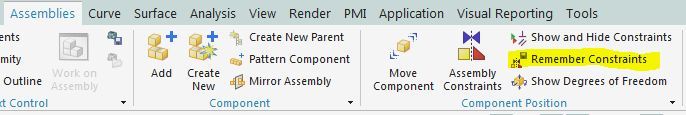

I know you´ve said I need to redefine them anyway, but where can I find remember Contraints option? just for curiosity...

RE: Maintain assembly constraints if I move a part from one subassembly to another.
fsh27, you can find it on the Ribbon bar under the Assemblies tab at the Component Position section, see the picture:
