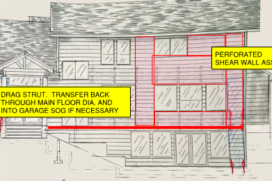

2.) On the east elevation in the picture below you can see that I have two stories with a daylight basement on the right side of the residence. Essentially three stories. I've got a couple shearwall segments drawn in but how to get much else out of this wall is causing me to scratch my head. Any thoughts on the best way to get more shear panels on this wall?

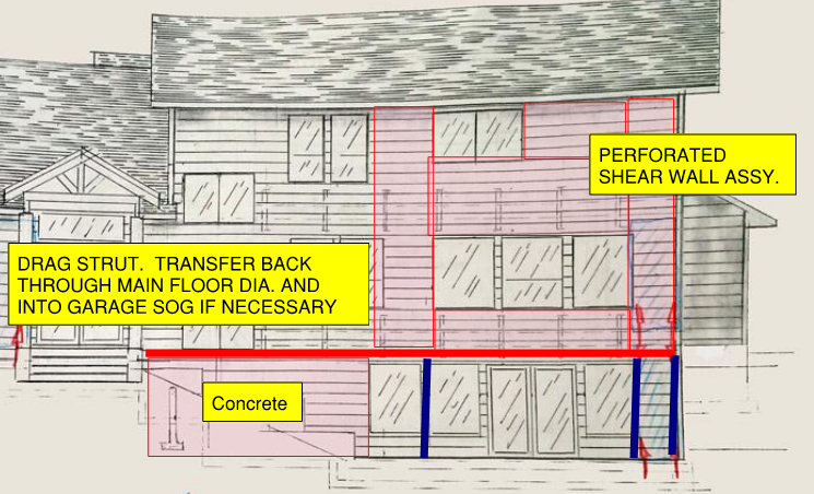

Quote (medeek)
The whole reason this designer calls me is because I can usually make his designs work when they wouldn't otherwise using the IRC braced wall method and other prescriptive methods.
If that's your competitive edge with this client then we'll have to dig a little deeper. See the sketches below. With some minor adjustment to the window locations, you should be able to slip in posts to take your chord forces to ground.

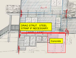

Quote (medeek)
If enough anchor bolts could connect the sill plate in this 3 ft section of the wall then yes I would assume that the shear load could be successfully dragged into the stemwall foundation and not worry about the stepped wall below.
Expanding the concrete a bit on the south elevation makes sense to me. Another option to improve matters is to use a steel strap of some kind as your collector at the main floor level.
Quote (medeek)
It's not apparent from the south elevation but the garage wall is 4 ft out of plane from the main residence wall.
This complicates matters but is not necessarily a deal breaker. You may be able to transfer the shear down to the main floor level and then across the main floor diaphragm laterally to get the load over to where it might transfer to the garage floor system.
RE: Stepped Foundations and Shearwalls
More gooder...
I like what I am seeing KootK, however with a perforated shear wall doesn't a full height wall segment need to be at each end per Item 1 of 4.3.5.3. I think I could remove the left most basement window of the East Elevation then bring the concrete up to the edge of the perf shear wall you have drawn in for the first and second floor. If I use a drag strut back to the top of the foundation I probably can eliminate the 3 ft shear wall panel in the basement wall.
Someething along these lines:
The south elevation I did not redraw since I will go with what you have drawn above (KootK), I think that is probably as good as it gets.
Quote (medeek)
I would argue that, in all of the ways that matter, the perforated shear wall is done being a shear wall once it hits that main floor drag strut. After all, theoretically, there would be no shear required in the panels below the main floor. As such, I'd be willing to leave that one basement floor window alone.

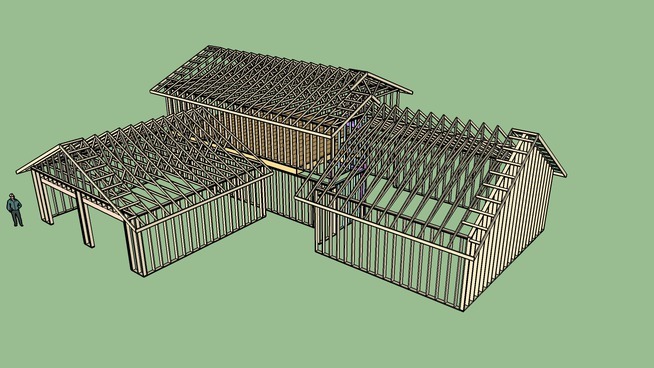

The shearwalls are only one of the issues with this particular design, I've also got an interesting wall of windows on the north wall as well as some interesting roof lines intermixed with a stairwell and beams. In hopes of better sorting this all out I'm going to meet with the designer tomorrow and see if I can gain more clarity and see how he feels about removing some of the steps from the foundation at critical locations.
A really rough mockup in SketchUp is here for those interested:
https://3dwarehouse.sketchup.com/model.html?id=b22...
Quote (kootk)
I agree about leaving the window since everything is transferring in shear to the concrete through the drag, but the vertical chord holdown above this header (from the left side of the perforated) would need to transfer to the header and then have a holdown on either side of the header that goes to the ground.
