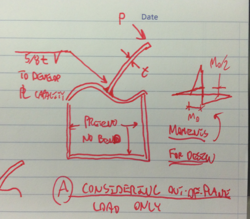

Is there any information on designing a single plate or gusset plate connection to an HSS column (or WF for that matter) that is subject to out of plane loads. Particularly when the plate is welded to the face of the HSS.
How would you check the HSS face for this concentrated moment?
Would check the weld using some sort of T=C=M/d force couple?

1) design the plate for M/Zx flexure.
2) design the wall connected to the plate for M/Zx flexure assuming that the other walls don't participate.
3) assume the effective width of the wall to be the same as the plate length.
4) use a pair of fillet welds at least 5/8 the plate thickness. There's stuff in AISC suggesting that's enough to effectively mobilize the yield strength of the plate.
5) due you due diligence in combining the out of plane design with any other significant effects present.

Perhaps your loads are small, but replace that plate in KootK's sketch with an appropriate WT mounted with flange against HSS and you'll likely get:
1. better deflection performance, (check WT prying in flange)
2. more economical welds (flare bevel) to the HSS due to increased moment arm between welds (the 'd' of T/C = M/d in KootK's sketch is very small)
3. no local stress concerns on the HSS wall (if WT flange is of appropriate width to dump loads directly into HSS sidewalls)

I like KootK's approach but you might want to consider using a full penetration weld to make sure you get the same strength as the plate.

To clarify:
From a mechanical perspective, I very much like the WT solution as well, particularly for larger loads. I simply focused my efforts on the "how do we engineer this particular configuration" question rather that on alternate strategies. Which is not to say that alternate strategies don't also constitute sage advice.
While I do like the WT system mechanically, there are some potential drawbacks to consider:
1) I get push back from some fabricators regarding the cost. I think that the shear tab fabrication is something that is more a part of standardized fabrication procedures in some shops.
2) I get push back from some fabricators on the use of WT's. Many claim that it's cheaper for them to plate fabricate the WT's instead of ordering them. And, once the tees become plate fabricated, you're back to having to worry about the WT flange/web weld again.
3) Using the WT's really just moves the HSS wall bending problem from the front face of the HSS to the back face. Although, I suppose, one could argue that the effective participating length of wall would be larger when looking at the back face.
4) I've experienced a lot of quality control issues with flare bevel welds. And I like them much better when used in longitudinal shear applications. With flare bevel welds, the couple will basically be resisted by the welds acting in tension. That's not prohibited, I just like it less.
5) With the flare bevel weld approach, you probably want the WT flange a bit wider than the columns. And that may be exacerbated by the fact that your WT web will likely be off center to allow the beam web to remain on center. Those things combined mean that, if you're trying to bury the system in a stud wall, doing so probably just got a little tougher.

I've done what KootK is suggesting, but I've also on occasion been a little aggressive and assumed that the HSS wall has some frame action going on with partial fixity at either end.
Have a quick conceptual look at deflection, too. The rotation at the base of the cantilevered plate due to bending in the HSS wall could become a problem
I normally wouldn't use a WT if I were doing this. If I needed to reinforce I'd use fabricated plates. WTs aren't really the right proportions. You want a thick web plate and likely a not as thick flange. Basically, you end up with a weird WT shape being required, and you probably aren't doing many locations. So the shop buys a WT length that they won't use the whole piece of and you're compromising to something that isn't necessarily all that efficient. Might as well just have them build what you actually want out of standard plate stock.
