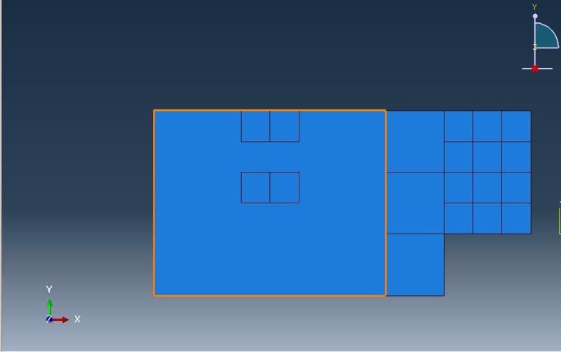

I have an object in Abaqus which I should set two different materials mixed together. I am trying to do it through Python but I do not know how to select the elements I would change the material of. Does anyone know how to change the material of a set of random elements?

Do you have the names of the sets?
If so then you can assign the sets a section & material eg...

RE: Heterogeneous material Abaqus
I mean I need an object with a material, iron for example, and small intersections of another material spread through my object. This way I will have two parts with different materials
Yes & the way to do that is to create 2 element sets & assign the different sets different properties & sections.
