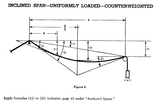

I am trying to model a communication (Telephone cable), in STAAD, strung between to points which are not at the same elevation. I know the properties of the cable (Area, Density, Modulus of Elasticity and initial tension at two ends under the self loading) but I don't know the sag and the cable length . I have used the "CABLE" element in the STAAD and was expecting that the cable will sag under its own weight and then I'll be able to get the maximum sag, but it seems that the "cable" element is not any different from truss element and it does not give any deflection under the self weight. Could somebody advise if there is any other way of modelling the cable and to find out the resultant sag, or could somebody suggest a good literature for hand calculations. I can only find literature for cables without initial tension and with ends at same elevations. Could somebody help. Thanks

If your sag is less than 8-10% of the span length, you can use parabolic equations to hand calculate the tension/sag.
The basic equation is T=w*l^2/(8*d) where T is horizontal tension, w is self weight, l is horizontal span length, d is sag at midspan.

The parabolic equations that Lomarandil mentioned can be found in the "US Steel Wire Rope Engineering Handbook". It can be downloaded from the middle of this page of my website: Miscellaneous
Page 50 shows what I understand to be the conditions you are interested in:
Page 50 refers to equations on Page 43:
The section of the book concerning the diagrams shown above begins on Page 38.
