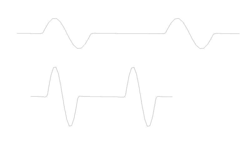

I wonder can anyone please help me understand the defining of arbitrary waveforms, using something like for example a Sigilent SDG1020.
I am thinking of buying this SDG1020, so I have trawled around a bit but can't find the answer I'm looking for.
I'm curious if, for example, lets say I have a portion of a captured wave that I want to use as a part of my arbitrary wave, is there some feature that would let me capture a portion of the said wave with an oscilloscope, then transfer this captured portion into the arbitrary waveform generator, where I can then edit it down to very portion that I want use?
My aim is to capture the pulse from an ignition's magnetic pickup using a scope, then transfer this pulse to an AWG so that I can use the AWG as an engine speed simulator.
I realise that a simple sinewave could be used, (along with a dead period to represent the time delay between pickup pulses), to mimic the engine pickups output, but I am just curious as to whether these AWG or any AWG machines will let me capture a real wave in a scope, then use this as the basis for my arbitrary wave.
I intend buying a scope also, so the description above doesn't relate to a specific scope, since I haven't bought it yet either. Any advice in that regard might also be useful.
This is purely a hobby based purpose, so I obviously don't want to fork out a huge amount, but don't mind spending £400 or £500 for both of the above in total.

I just rang Siglent and asked the question directly.
Apparently there is no way to replicate what I want directly from the AWG, without having it hooked up to a PC and running a program live from the PC.
Does anyone know an alternative device which can carry out the frequency variation, with amplitude varying simaultaneously, as a function of frequency?
All I want is something that can sweep from the first image to the second image, by the turn of a knob.

RE: ARBITRARY WAVEFORM DEFINITION
@waross Thanks, but I already have that set up.
I prefer the idea of having more flexibility and less mechanical hardware.
It's not so easy getting a motor that can rotate steadily at 200rpm, which can also rev up to 16000rpm
It's quite a range to accommodate.
I realise there are ways to achieve it mechanically, but I prefer not to go down that route, since
soon it becomes almost as simple to just use a real engine, which obviously defeats the purpose of creating a simulator.

Yes, with an arduino. Preporgram it with a shape function that is voltage dependent, and a frequency output that is voltage dependent.
So, you've got a pot, and you want an output peak voltage proportional to frequency then something like
signal_out=V_pot*sin(V_pot*time)*mark_space_function(time,V_pot)
http://www.instructables.com/id/Arduino-Waveform-G... is the sort of thing.
