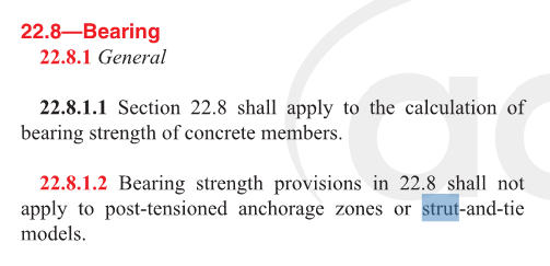

That is encouraging. It seems pretty clear that STM procedures have been constructed around 2D considerations and, no doubt, that is producing conservatism with regard to nodal bearing. It's a bit scary to contemplate going rogue on it, however, given the statement shown in 22.8.1.2 below.

That's '14? I don't have a copy handy.
The problem is that I'm not trying to go rogue but explain away already rogue behavior to avoid reinventing the wheel and getting a lot of pushback.
