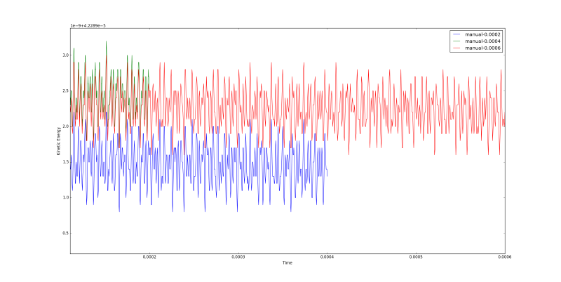

I am simulating a ball bouncing using Abaqus/Explicit. I have noticed that if the total time of the simulation is changed theresults also change, which I think does not make sense as the whole setup is the same except the total time.
Here is the plot of Kinetic Energy vs Time for 3 different total times.
After I zoomin, I would expect the plots to overlap, but I find that the plot do not overlap.
I am using automatic timesteping for the simulation. Also the 'Initial time increment' is the same for all the cases.
Can anyone explain why this happens?

I'm going to assume it's related to the automatic time stepping. Whatever it is using for the 0.0002 and 0.0006 values is probably a similar time step. The 0.0004 maybe somehow triggering a different automatic time step. The thing to always remember about FEA is that almost every parameter (time, mesh size, force distribution, force vs. time application, stress-strain curve) in real life is a continuous system, yet we are representing them with a number of discrete points, therefore every parameter must be tested for convergence to find when we have a value small enough to represent the "infinitesimal" well.

I'm quite sure, that the issue is related to output. The output times are not equal and with that high frequent behavior the curves do not match. When you apply a filter the get rid of the noise, the issue would disappear.

Okay, I understand that the automatic time step might result to different time increments for different total times based on various factors with the ultimate aim to reach convergence.
Do a similar optimization also take place when a user-defined time increment is used? I guessed in this case a constant time increment would be used throughout the simulation. I tried it with fixed time increments and got a similar graph.
Or can I just assume it as some numreical error?
@Mustaine3 -- I am a little unclear about your point. How do I apply the filter? Can I apply it using Abaqus post processing? or using python, MATLAB?

Numerical errors are always there, but usually the error/difference is quite small. So it depends on the scale you are looking at. Very small differences can also come from different versions, OS, domain decomposition, ...
Filters are available during the generation of output and also in postprocessing, when you operate on xy data.
@IRstuff
I think I know what you mean, but the step time should have no influence in the stable time increment.
At longer runtime the round off errors might become an issue. Running the job in double precision can help here.

Quote (sanju261991)
.. automatic time step might result to different time increments for different total times based on various factors with the ultimate aim to reach convergence.
There are no convergence checks in Abaqus/Explicit.
