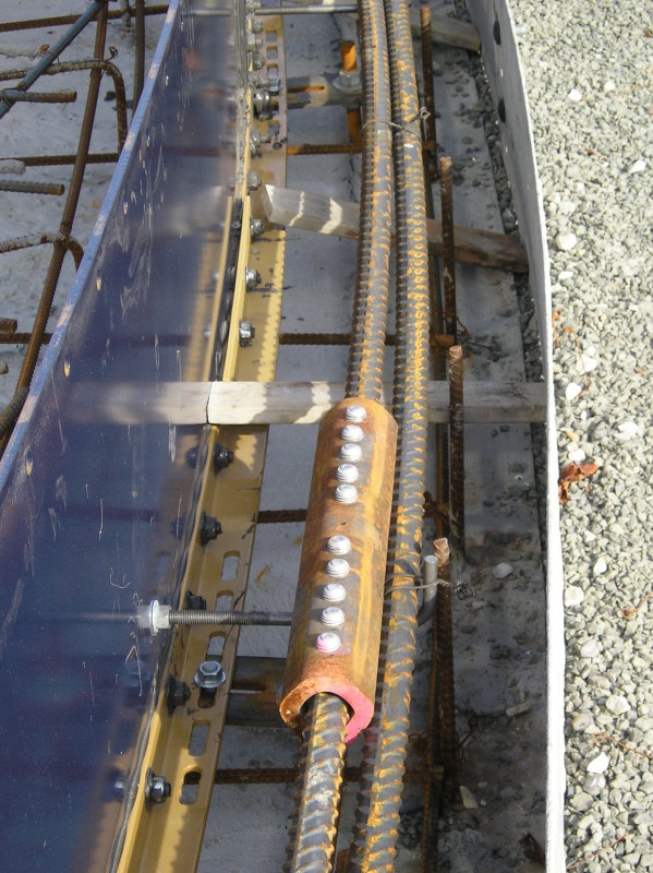

Has anyone ever used or heard of Zap Screwlok Bar-Splice Products?
They appear legitimate to me, but, i just want some experienced support.
The contractor would like to use them in a tensile tie-rod application.
Any thoughts? experience? concerns?
Thank you!

We are currently using them on one of our projects to couple column reinforcement. They work well when installed properly. You'd be surprised how many contractors haven't used them before and install them incorrectly (as crazy as it sounds installation is not necessarily fool proof). My only word of caution is that the ESR report that WannabeSE linked to indicates their use is for deformed steel reinforcing bars. Other applications may go beyond the scope of their testing.

In this part of the world a similar type exists via a few suppliers, one common property they all share is that they can yield the bar, but they do not possess sufficient strength to fracture the bar (to reach the ultimate tensile capacity). This means they are generally unsuitable for any application where ductility is required
RE: Zap Screwlok Bar-Splice
There are two specs of splices, one that will take full specified tensile (Type 2) and one that will go to 125% of yield (Type 1). The Barsplice products are generally very good products, along with Erico, Dayton Superior, and a number of others. You should be ok as long as they comply with the relevant ASTM a1034 for testing splices.
Probably not a problem in a tension tie rod application, but be aware that the splices take up a fair amount of room, and may cause dislocation of bars or loss of cover.
