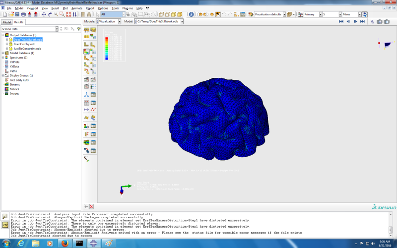

I am building a model where I have two layers of material. The outer layer is growing faster then the inner layer in my model. When I use partition to separate my two areas everything works great and I get the results I expect. However when I use the tie function, iterations or merged assembly I have not been able to get the results I expect like i am getting from partitioning my two layers apart. Does anybody know what setting I may be missing that would make these layers interact the same way they do when I partition them apart? The only reason this is a problem is that the next step is to apply this to a more complicated geometry and I will not be able to partition the sections apart in ABAQUS.

Yes my two parts are deforming together. My outer layer is slightly stiffer then my inner layer. I am using abaqus explicit my densities are the same. And I expect relatively large deformation. My test case is on a half sphere where the outer layer has thickness of 2 and inner layer has a radius of 48. I expect the see the surface buckle and fold against its self. My step type is dynamic explicit and I am increasing the temperature of my system to simulate growth.
RE: Tied vs Partition inorder to have 2 layers connected
It appears that my problem is that the only way that I can get my parts to deform together is by using partition in all of the other methods I have tried my base layer does not deform with my surface. I am wondering if my problem is that some how my surfaces can slide across each other. The models where I use methods other then partition I get spikes that grow out of my surface.

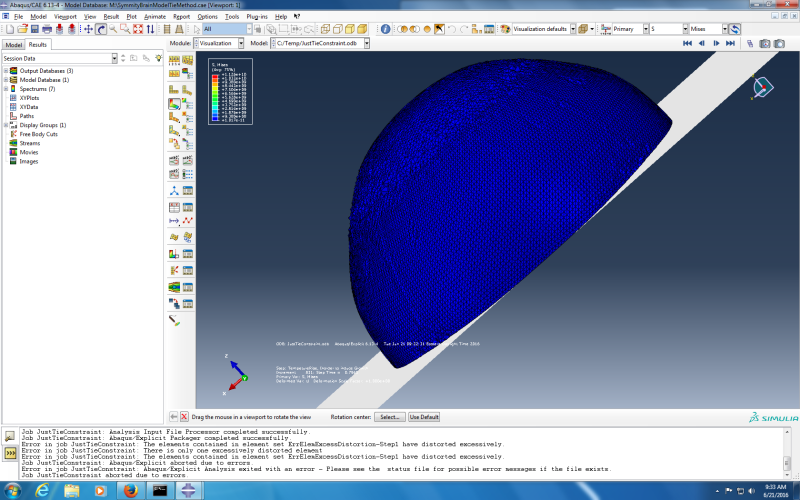

That is one of the setups that did not work. I tried running just tie constraint again and got a very similar result to this one. In this you can see that it is forming spikes instead of building up pressure and then bucking
This is what I get when i partition the two layers out of a single object. This is the result i expect to get but am not
I don't understand what is going wrong. The most promise I have seen from any of these models is the rough contact with no separation set on the normal behavior but it still looked like my failed case where I had my outer layer forming spikes instead of buckling in on itself. I have found that the correct model takes much longer for Abaqus to process and it normally takes about 2 hours to run while all of the ones that form the spikes take about 10 minutes. With the tied condition I am having some of the surface move with the spikes that are forming but I it is still very far from being the bucking seen when using the partition method. I think the problem starts early in running the model analysis. When I use the partition method the model has uniform stress distribution all across the system however when I use any other method I do not have this uniform stress distribution instead the top of my model has lower stress. I expect that the problem I am getting is from this and the spikes reliving the built up stress instead of the system bucking very rapidly when a maximum stress is reached. Is there a setting in the tied condition that I am missing, I have tried both analytical default and surface to surface? or maybe a way to influence the mesh to help it have the uniform stress early on in the simulation?

I ran a simulation that took a while but dropping the density in the tied model did solve my problem. Does anybody know why this worked I would really appreciate any insight you may have into this phenomenon. But for anybody who may work on a project and has a problem with tied vs partitioned sections in a dynamic explicit step the problem that it seems that i ran into was that is stopped calculating it as a dynamic explicit step and lowering my density seemed to give some promising results I lowered my density from 640 to 0.01 in this case.
