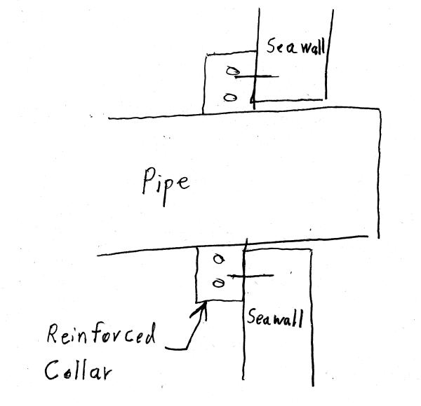

Consider sawing the hole per your Option 1.
Install the pipe and grout it in place (no rebar or dowels at this time).
Then drill and install dowels in the face of the wall (either side).
Form and place a reinforced concrete collar that encases the pipe.
You want to keep each step as simple as possible when working under adverse conditions (below ground level) and in tight spaces. See the sketch below:
www.SlideRuleEra.net idea
www.VacuumTubeEra.net r2d2

Would this detail transfer the flexural load in the wall to the ends of the wall? Perhaps, I misled with the wording of my post, see sketch below of an elevation view of option 1:
I think a collar would be a good option for restraining axial load in the pipe. In this case, the pipe is not pressurized and will not have any axial load. I'm concerned with ensuring that the load path that is being interrupted in the wall with the large hole can be redirected via a detail of some sort.

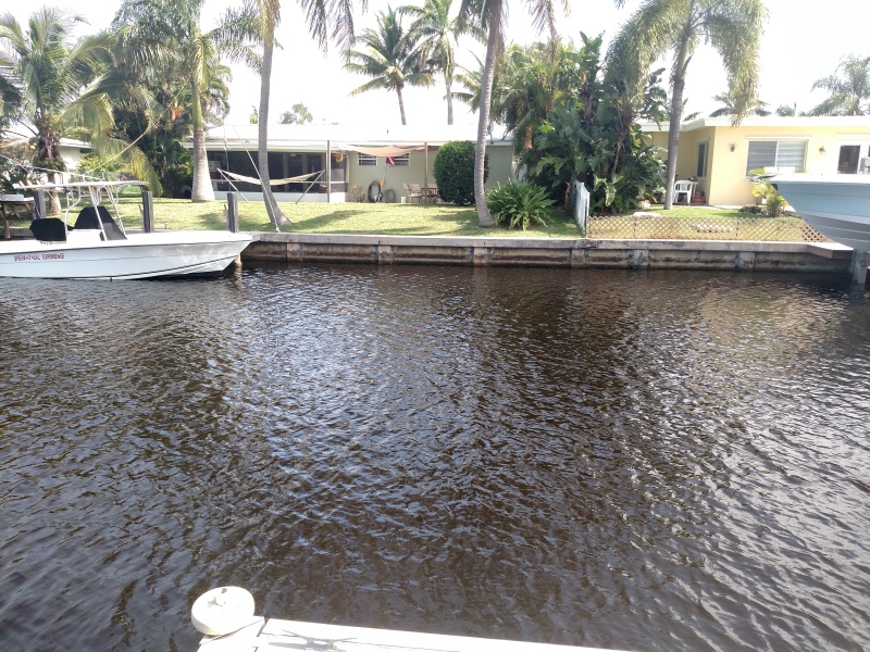

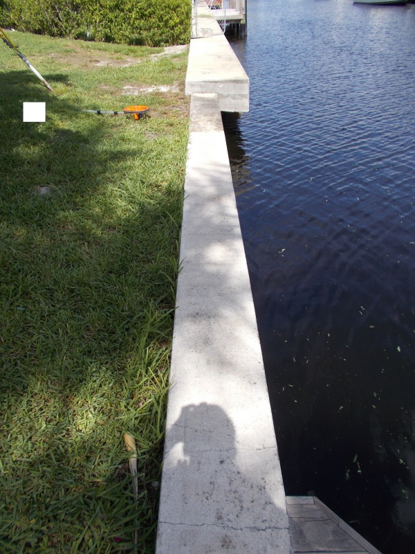

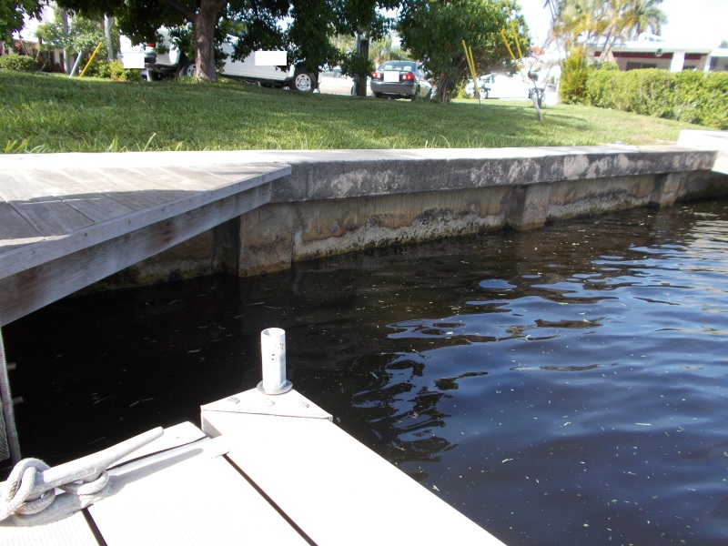

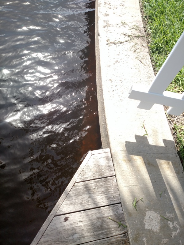

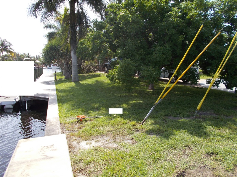

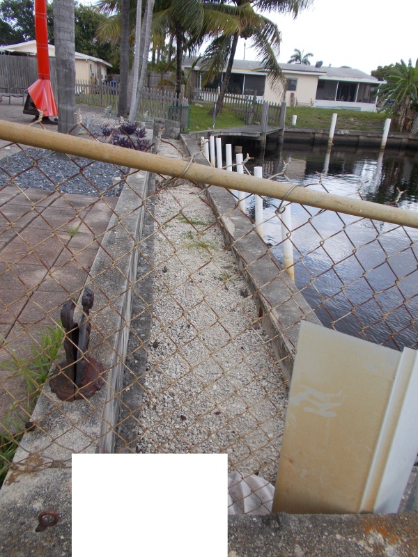

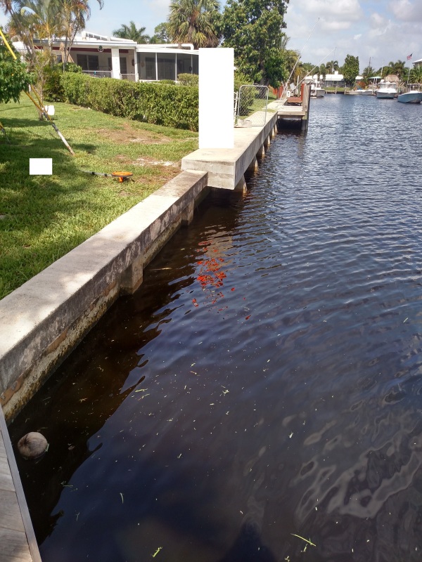

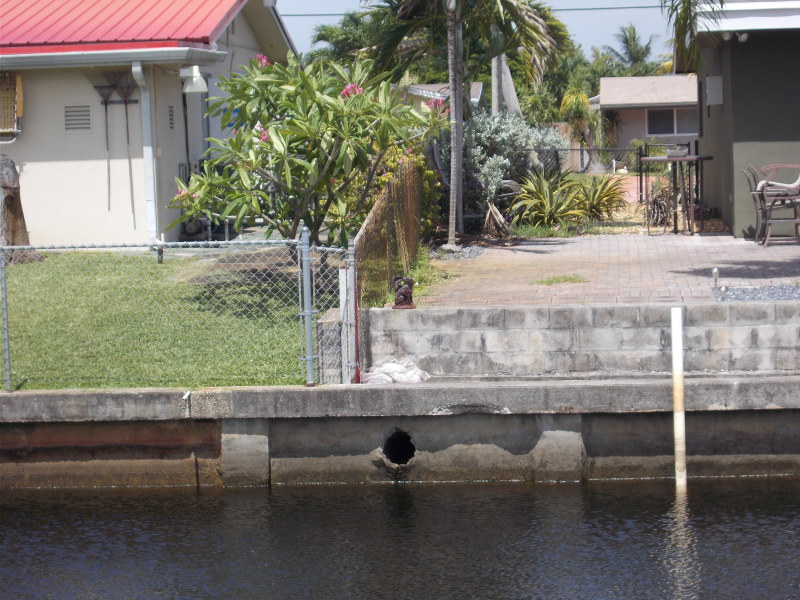

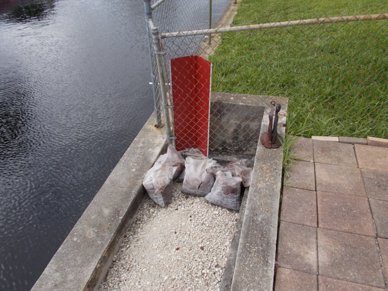

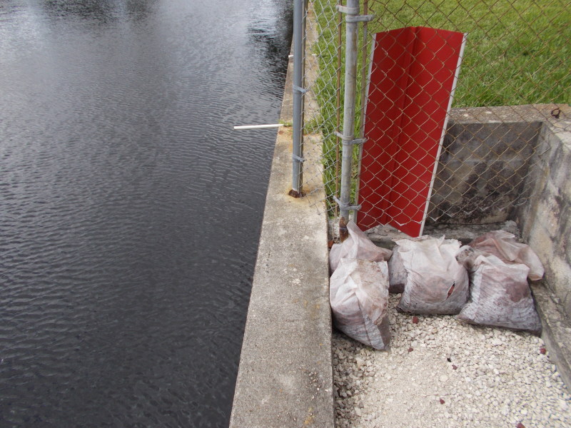

I got out to the field to see each of the walls. I have attached a few photos for reference.
Here are some of my observations:
  • The walls are not driven concrete sheet piling as I expected, they seem to be cantilever retaining walls - I could see the front portion of the base slab.
  • The wall does not seem to be tied back. The pile cap is about 9"Hx16" and 9"Hx13.5". From the dock where I was able to see the wall from, I did not see any evidence indicating that wall is tied back. I also did not see any indication of tie backs in the pile cap on the land side.
  • I measured the distance to the top of the base slab of the wall at each site. At one site (Site A), where a 72" RCP is being proposed, the wall is 4'-4" tall - measured from the top of the cap to the top of the base slab. At Site B, where a 48" RCP is being proposed, the wall is 6' tall. There is survey information for the canal at Site B but, not at Site A (I expect to get some more survey information in the next few days.)
  • There was some cracking in the pile cap at Site A, although they appeared to be shrinkage cracks not shear or flexural cracks. At Site B, there were some rather large cracks in the cap which, can be attributed to poor work performed by the homeowner or a contractor to install irrigation drainage lines. There was a large area of spalled concrete with corroded rebar evident, which is visible in one of the photos.
  • The fill on the land side of the walls goes up to 2" below the pile cap at each site.
  • The walls at each site are located in residential areas and as such there are houses and driveways nearby. At Site A, there is a house >50' set back from the wall, a driveway about 30' away, and the roadway (end of a cul-de-sac) about 27' away. At Site B, there are pavers and a 2' high wall adjacent to the sea wall and two houses set back about 25'-30' from the wall.
  • The water is brackish water. The water is tidal - the closest NOAA station about 4 miles away recorded a tidal range of 3.1 ft., which is typical for this time of the year based on the annual report for the station.
The 72" RCP does not seem to be feasible at Site A, unless the bottom of the canal is a few feet below the top of the wall slab. A new section of retaining wall would have to be constructed and tied into the existing wall. I will need to see the survey to see if this will work geometrically.
As for Site B, although the 48" RCP would technically fit within the height of the wall, the opening for the RCP would essentially cut that section of the wall completely. It seems that a similar scheme to that discussed above would have to be developed. I'm concerned about how the existing wall would behave once a new section of wall is constructed and "tied" into the existing - there is no way to check the capacity of the wall as there are no As-Builts.
Site A Photos:
Site B Photos:

supstr - Good photos. I agree with you that cutting through the wall at either site is not feasible. The overriding issue it that the pipes, or least a good bit of them are below the water line. The only practical way I see to construct the project would involve building a temporary cofferdam on the canal side. Extensive dewatering of both the cofferdam and soil on the fill side of the wall would be required to keep the work area "dry".
I looked up typical specs for both 48" and 72" RCP. The 48" weights well over 800 lb/ft (about 3 1/2 tons for an 8' length of pipe). The 72" weighs over 1800 lb/ft (more than 7 tons per 8' length). Threading pipe though a small sawed opening would be a challenge... and that assumes that the necessary large openings do not compromise the structural integrity of the remaining wall. Assuming that suitable pipe bedding is installed (in a dewatered pipe trench), there is the real risk of differential pipe settlement. That is, the pipe or the bedding, or both settle but the wall (with its grouted-in pipe) does not. Then most of the weigh of the pipe is now being applied to the wall. One potential solution would be to put pipeline near the wall on driven piling, instead of bedding. In fact, putting the entire pipeline on piling may be prudent.
From your description and photos, IMHO, consider these steps:
1. Completely remove necessary parts of the wall, all to the bottom.
2. Build the cofferdam and perform dewatering as needed (probably both pumps and well points).
3. Install the pipe on bedding if possible, otherwise on piling.
4. Replace the removed portions of the wall with a suitable free-standing pipe header / retaining wall that adjoins, but is not connected to the remaining existing wall.
No matter what approach is taken, this is going to be an expensive project.
