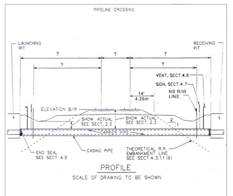

In my experience working with the railroads, only pipe located within the "theoretical RR embankment line" was required to be encased. If the pipe was run parallel to the tracks and outside and above the "theoretical RR embankment line", casing was not required.

When they added CMP as a casing is when they lost me. That is not as strong as RCP or steel. If it is not under the track it should not be an issue. Find a contractor that has done work for CP Rail and see what they installed.
