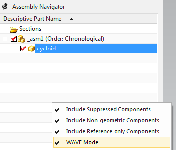

1. Right click in the Assembly navigator and make sure that WAVE-mode is on.

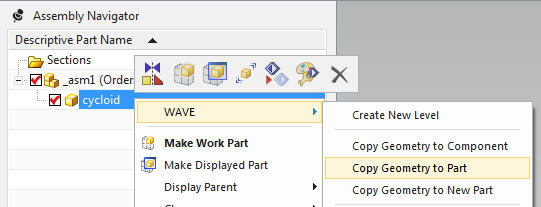

2. Then right-click on the part you wish to make a new link from and choose WAVE - Copy Geometry To Part as it shown below:

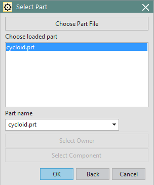

3. Next window will show you all parts available in the current session (but you'd be able to choose the part file also from your file system or TC environment). Choose a part you want to copy a link to:

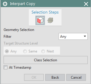

4. Select a needed geometry for WAVE-link:
The result feature is shown below
