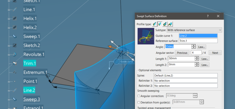

Ok I did not check any value for real drill bit, and I simplified the main section but you can apply this to your construction:

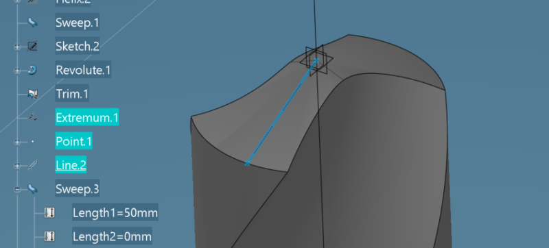

Create a line from drill bit tip to a location on the edge (I use extremum point):
Create a Sweep Surface using the line as Guide Curve and the conical surface as Reference:

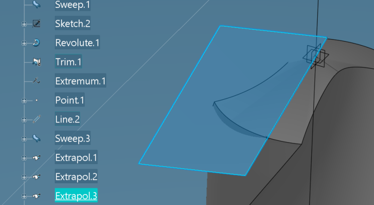

extrapole in 3 direction (not the edge from the line):

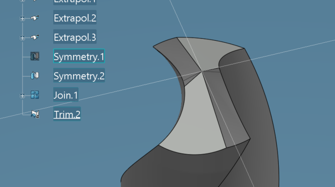

Symmetry twice (or rotate 180deg) and join (uncheck Check Connexity):
Trim with the drill bit surface:
You better check real drill bit geometry but I am confident something like that could help you.
