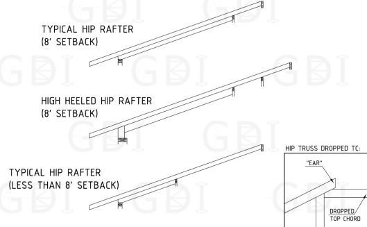

This is the California Hip Set:
View model here:
https://3dwarehouse.sketchup.com/model.html?id=c17...
The problem I am having with this variant is the conflict between the 2x6 hip rafter and the top chords of the step down hip trusses.
A confused student is a good student.
Nathaniel P. Wilkerson, PE
www.medeek.com
RE: Half Hip Truss Set
Your step-down hip -
I'd say you have it about right. But I have never seen a manufacturer stick with a specific setback, like 6' or 8'
What I've always done here (Central Illinois) is something this: There's a common truss at the peak. The first step-down has a 4' 1 1/2" flat top. Next one has an 8' 1 1/2" flat top. And so on down to where the setback is 8' or less.
For instance - A 32' hip set. Trusses are stepped down until the girder, which has a 16' 1 1/2" flat top. That leaves a setback of 7' 11 1/4".
The reason for the 7' 11 1/4" setback is so that the jacks work at 2' O.C. all across the end. Otherwise you'd have an odd space and the framer would have to cut plywood.
On long span hip sets (Like 60 feet or more) the setback sometimes has to be greater so the hip girder has more depth. Then you have to get creative in how you do the corner sets.
The california hip -
We always figured the plumb cut of the hip rafter, and made the flat top of the hip girder low enough so that it passed over it without a birdsmouth.
The trusses behind the hip girder were often the same as one ply of the girder, with the top chords extended to meet the hip rafter. That reduced the number of setups.
The Northeast hip -
I've only seen drawings of it. Never have seen it done in practice. But things are very regional, so it might well be popular elsewhere.
I've just measured the dimensions on the stepdown hip set and they match your numbers exactly as outlined above.
The problem I'm having with the california hip set is that I'm using a 2x6 hip rafter. If I drop the flat top of the hip girder so that I don't have to birdsmouth cut the rafter then the top chords of the end jack trusses do not bear on the top of the hip girder. I've seen some examples of the california with the trusses beyond the hip girder all the same as the hip girder except for the top chords extending up to the hip rafter. It would seem better though to have the flat tops of the hip trusses so that the jack trusses bear directly on them otherwise additional blocking will be required to provide support for the top chords of these end jack trusses. However, I do see the economy in making them all the same size and reducing manufacturing costs.
Reading various threads and blogs on the internet I came across the stacked hip rafter, I think this is the solution to the conflict between the hip rafter and girder truss top chord:
