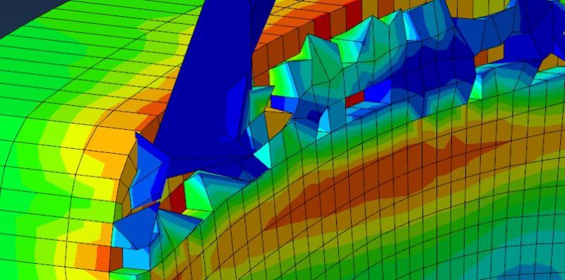

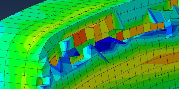

Now my main question is this:
How should we specify the Maximum Degradation Value ? And know this value is correct ?
As Far As i search in web different values (0.5 and Default and ...) set to it.
Or This a Trial,Error procedure ?
Because i have simulation of damage with element deletion, i run it (without Error and Warning) with default Maximum degradation, some elements get deleted but some stick to the part and distorted slowly (without warning and error).
But if Max Degradation Value set to 0.5 that elements will be remove from analysis. But how much this value affect on simulation is a question ?
Image 1 (Max Degradation=0.98):
Image 2 (Max Degradation=0.5):
