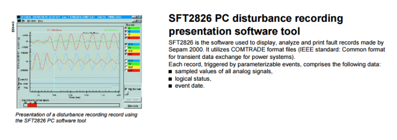

Have you looked at the relay event reports? Specifically, the relay should be able to record the Idiff. When transformer is energized, have you measured the currents at the relay? I have seen this before and most likely it is either a incorrect connection or CT ratio. As the load increases, the Idiff becomes greater than the setting and causes a trip. The Sepam relay should have this information available in event reports.
RE: Transformer Differential Protection trip Fault
Like DTR2011 said. I don't have experience with the SEPAM 2000, but according to the spec sheet it records the fault data in standard comtrade format. If you can upload the comtrade file from one of the trips we would be able to provide a better guess of what is happening.
http://notronco.com/dnl/catalogue/schneider/MGC/AC...
Never used a Sepam 2000, but I have seen similar happen where the relay was programmed with the wrong transformer winding vector group.
If the event records don't turn up anything too suspicious, that's where I'd look first.

Post a COMTRADE event file from one of the trips. There's a how bunch of possible things that can be rapidly ruled out once the event report can be reviewed.

Comtrade file ans event list from relay are needed
