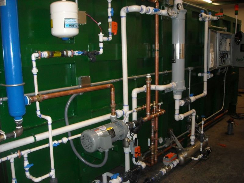

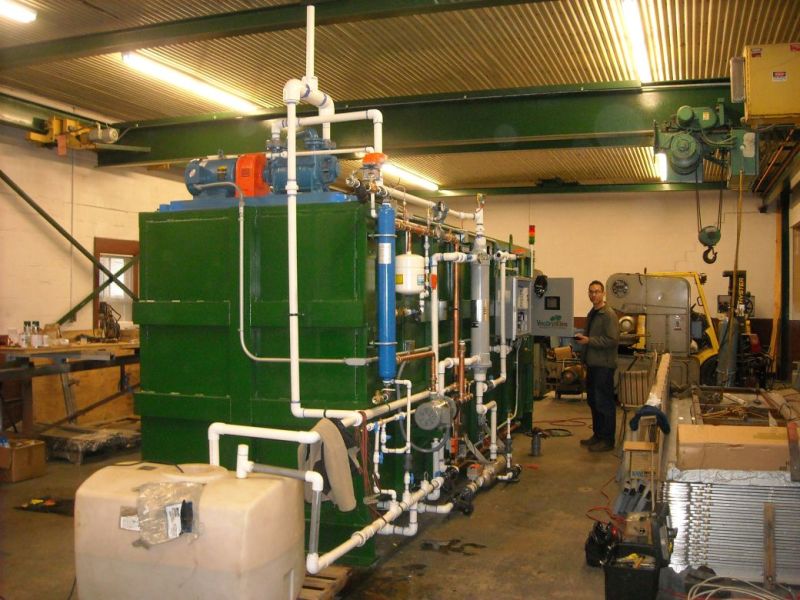

This is the kiln that is giving us trouble. We have built the same system many times. The blue vac pump is on top.
The tank at the end is temporary seal water for testing. Here's another.
The grey shell and tube is the condenser. The condensate falls into the SS tank. Everything has strainers.

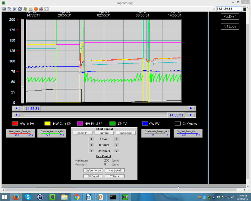

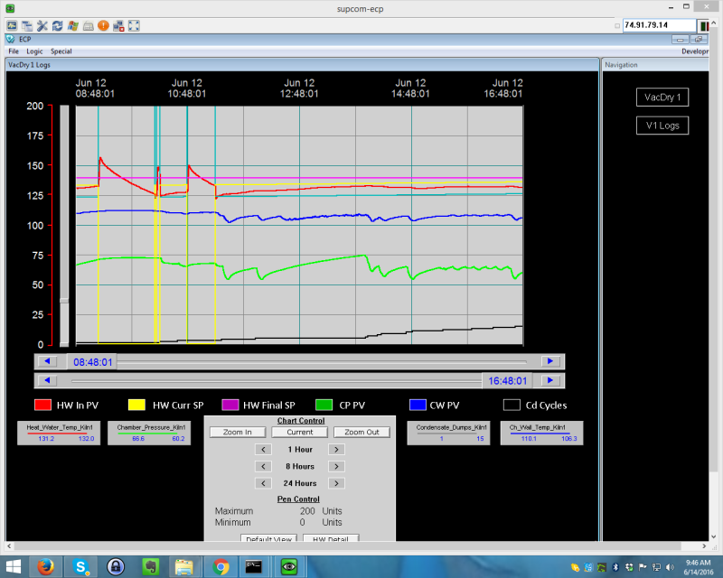

Yes the VFD overloads but I think I have an idea. This has never been seen but there is a first time for everything. Following are three screen shots from this kiln. The green line is chamber pressure. The black, stepped line is the PLC dumping the condensate collection tank. When that black line goes flat, there is something wrong with the level sensor. I wonder if there could be so much water backed up that it is starting to flood the condenser. Vacuum pumps don't like to lift water!
RE: liquid ring vacuum pump
I'm glad you understand those traces, because without a P & ID and a GA with knowledge of which instrument is which line, it means very little to most of the rest of us.
If the inlet line is becoming blocked or full of water then yes, the vacuum pump won't like it.
For any intermittent fault you just need to look at potential causes and gradually wipe one off after another. Start with easy things like checking all the sensor inputs - impulse lines can block and calibration of instruments can drift. If the control system is getting duff info it will make bad decisions.
The key one will probably be a need to strip down the vacuum pump or at least remove all the connections and have as good a look inside the pump and piping as possible.
A good log of what was happening each day and trip will help as operators have a habit of not telling you the full story and blaming the pump is an easy out. Getting access to the control system historian is a good idea to see what was actually happening as opposed to what should happen.
Let us know what you find, but clearly something is not right on that bit of kit and my feeling is that it is not the vacuum pump....

I agree that the graphs don't mean anything if you don't know the assignments. The point was the green line. Look at how many times the darn thing can start without a problem.

Only other thing I can say looking closely at the photos is whether the condenser piping works well. Looks to me like the air inlet is at the bottom fighting with the condensate drain down to the stainless steel tank and also the line from the top of the condenser doesn't look like it has a slope on it back to the condenser. If you're getting start / stop then is there possibility of water collecting in it over time which then hits the pump as a slug?
Try angling all the inlet pipe back to the condenser as an easy win to eliminate this.
