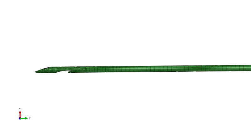

I have the model in mm, modulus and yield in MPa and density in kg/mm3. I initially tried with tonne/mm3 but that resulted in element failure in the tip of needle. So I changed the density with kg/mm3 and the model run smoothly for the same with no element failure.
My model is needle displacement into the rubber based eulerian analysis. The needle travel through the rubber material up to 10mm. I am trying to find the resultant force for given 10mm displacement.
I HAVE ATTACHED THE NEEDLE MESH IMAGE OVER HERE

7.8e-6 kg/mm^3 and 7.8e-6 kg/mm^3 may be numerically equivalent densities but you need to specify the one that is consistent with your adopted mass, length and time scale. In the case that you have specified your geometry in mm, forces in N and time in s, you must specify density in tonne/mm3.
The mesh at the point of your needle does not look great - the elements are long, thin and skewed. It is these elements that deform and become distorted when you use the correct density. When you scale the density I guess these elements don't see as much deformation and the analysis completes. But you have no justification for doing this?
Also, if your testing is dynamic or your material model for the rubber is rate-dependent you will be messing with all of the inertial terms by scaling the density.

I have meshed the same needle with finer mesh then what are u looking at long and skewed. I had meshed with 3 element in a row, 4 elements in the same row and now u can see 2 elements in the same needle tip row. The mesh at needle tip play only a part of role in distortion, where as stiffness play the main role.
So you think if I use kg/mm3 then I am scaling the model to 1000 times w.r.t to stiffness. I don't know if hypothetically kg/mm3 is equal to tonne/mm3, y would the result will be different and simulation has complete different approach towards running of simulation.

If you're trying to correlate your FEA force-displacement data to test data could you neglect the deformation of the needle and model it as a rigid part? That way you avoid excessive element distortion (as there is no needle deformation) and you no longer need to specify material properties for the needle so your stable time increment is not scaled by the very fine elements at its tip. If your needle is significantly stiffer than your rubber material your results might be OK? worth a try.
As you are running explicit I assume you are using reduced-integration elements and as you have only one layer of brick elements through the thickness of the needle tip at it is unlikely that you are currently capturing bending effects anyway.
