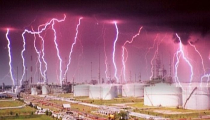

don't know where this is but it's pretty impressive. Is this what you mean?
