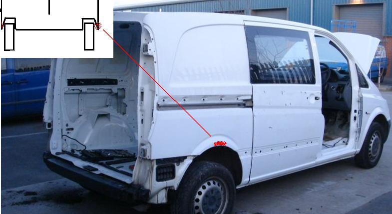

I know I exaggerated by asking to seal rust "for ever". Mostly I want to keep at this stage as much possible. Perhaps, purring from time to time linseed oil or cavity wax spray, I will extend the life of the car. It is quite difficult to arrive with any mechanical tool as there is a "V" shaped velding and the rust over there can only be stopped, not cleaned.
I attached a scheme and an image... not my car, but I did marked the rust on outside, bubbled paint and how it looks on outside arches. On inside, there is a thin crust of rust all over the arches.
The V shape, where the plates are welded, cannot be reached by mechanical.

You can convert iron(III) oxide to its tannic acid salt with a "rust converter" primer.
Is that better than removing the rust completely to clean new steel and applying a non-conversion primer directly to the bare metal? That depends on exactly how much sound metal is left underneath the oxide, how adherent the oxide layer is, and whether or not you can get to both sides of the repair.
Can you "seal" rust permanently so that it will never start again? Not really. But you can do your best to seal out water and other corrodents. You can also try to add an anode to protect areas where the coating is damaged, by using a zinc-rich primer. Those primers in my experience are not of any use except when applied to bare steel, and even then they have been less effective than I'd have liked.
The approach I've used on my own classic car is removal to bare steel where possible, followed by proper surface prep and a highly adherent base coat (typically a surface tolerant epoxy). I don't bother with the zinc rich primer any more unless it's a location where I can leave it as a finish coat. Any areas that are inaccessible, i.e. the insides of hollow structural sections, inside doors, places where panels are overlapped or spot welded together etc., are coated with a "cavity wax" type rustproofing material- a self sealing, self-healing coating of oil/wax that is reapplied every spring after the car has spent the entire winter indoors drying out. The one I use is "Rust Check" but there are many others. It's messy, and every seam looks dirty after a while, but it's really effective.

The truth is that I did a mistake by using wax cavity spray (from Teroson-Loctite) without using first a rust converter that I already had in my house (Kelfos rust converter).
Now, I know that the cavity wax already sealed rust in it's thin crevices and using now rust converter is useless in that arches area as will not penetrate as should do.
For the other parts I will not do the same mistake and I will use first rust converter.
But, for arches area I bought one liter of boiled linseed oil which I will combine with acetone to make it as thin as possible then, pour into the arches cavities. The acetone will dilute the wax too and will go deeper into the rust along with linseed oil.

Linseed (flax) oil is just an alkyd (drying/hardening) oil. You would be better served in my opinion using the cavity wax/oil which is intended for rust prevention, rather than a drying oil which will form a skin or film where it settles out. The cavity wax some self-sealing, self-healing capability that the alkyd doesn't.
