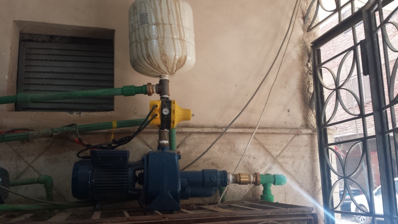

I have an inquiry regarding the Automatic pressure control DSK-8 (The yellow one(. (Check the pics below)
It does not work properly.
If I close the inlet valve, the device does not switch off the pump.
If I close the outlet valve, the device does not switch off the pump.
It was installed in a horizontal position instead of a vertical position.
Would you please tell me what could be wrong and how to fix it?
The device
Installation
Best Regards

Pressure gauge has nothing to do with the operation, all sensing in done internally. Normally start on drop of pressure run until no flow is taking place plus short run to pressurise the system. It has thermal overload protection and probably senses no water supply. They are usually very reliable, problem is possible incorrect wiring connection or a faulty unit.

Sorry, what I meant was the curious thing at the tee between pump and pressure bladder - looks like some sort of pressure switch with a guage on top - those look like some pretty thick wires coming from it ( but on looking very closely it might just be another hose??). The data from the unit says that it can only directly connect small pumps - hence needs to go via some sort of relay.

I just notice that you have the pressure tank mounted on the wrong side of the flow control unit, it should follow - not be prior.
Out of interest what is that horrible looking arrangement located directly on the pump discharge, get rid of it and rearrange the flow unit and pressure tank into their correct positions.

This is a pressure switch.it should not matter if it is before or after the pressure tank. It looks like the pressure adjustment screw is all the way in, so it is at it's highest setting, which is probably higher than the pump is capable of reaching. Turn the screw out while the pump is running until the pump turns off.
RE: Pump Automatic pressure control installation problem
The OP wants the pump controlled by the automatic pressure control unit DSK 8, not what looks like the original pressure control switch, simply remove it and put the pressure tank after DSK 8.

LittleInch, the thick wires are another pipe line not related to my pump. (Sorry for bad angle).
Artisi, 1- The thing just above the pump is an old pressure switch (another type). 2-I agree that the pressure tank should be after the device because it keeps the water flowing inside the device and hence, keeps pump running for a longer time.
Compositepro, the start pressure for the device is 2.2 bars while the pump provided a higher pressure (7.5 bars).
Regarding the electrics:
The device came with the wires already connected to it. I made a "splice" to connect to the wires to the main line and the pump. I double checked that the wiring is done correctly.
Regarding the pluming:
I checked the device. There is a metal piece at the outlet valve that moves if I turn the device upside down. I blew air from the inlet (while the device was in a proper position like the 1st pic in the original post) and the piece of metal moved up and back again when I stopped.
So I thought this piece of metal is a part of the device's non-return valve which depends on gravity.
I rearranged everything like the below pic following everyone's advice and now the device is working correctly.
