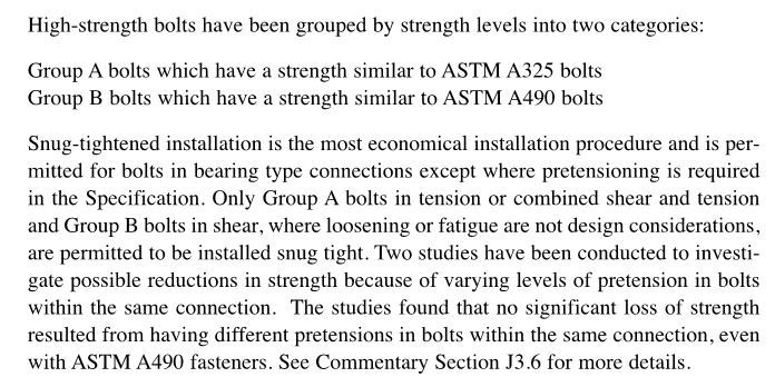

The latest version of the RCSC requires pretensioned joints for load reversal, not slip critical:

I posted this to create a discussion....which it apparently did.
One of the issues we deal with in construction is the lax procedural methods of "snug tight". Faying surfaces are to be brought into full contact! I see many times that unless there is greater specificity in the tensioning specification, this does not occur. ALL high strength bolts are to be tightened to a "snug tight" condition, at least. A non-specific requirement at best, other than the faying surface requirement.
I ran into a condition where TC bolts were used for numerous connections; however, they were not tensioned as required for TC bolts. The plans were vague and the fabricator could not provide shop drawings. An interesting condition at least. Why would a fabricator use bolts that cost 3x the normal bolt cost, yet not use them for their purpose? Further, TC bolts are very difficult to tighten to a snug tight condition without using a TC bolt tool (TC bolts do not have hex heads, so they are prevented from rotating during tightening with the spline engagement of the tensioning tool.) Does it make sense?
