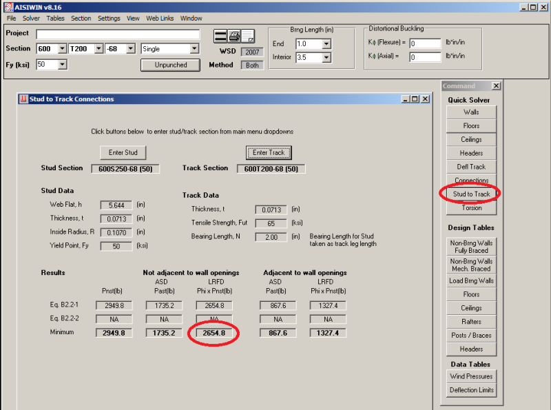

See the output below, it seems I am maxed out at 2.6 kips per stud (software doesn't have a module for built-up posts).
Currently, I am thinking about:
1. Switch back to a post hold-down that could also transfer compression? I looked at the Strong-tie hold-downs, but they are not rated for compression. Further, if I go back to that configuration, the shear needs to be resisted at the hold-down too. Not good.
2. Sketching to HSS chords
3. Reconfiguration my rigid diaphragm lateral load distribution in order to reduce the max chord compression to no more than 2x 2.6 kips.
Am I missing something here?

I believe the 2.6k capacity indicated in the program output for the stud to track connection is for an out-of-plane end reaction of the stud to track (web crippling type load) not an axial bearing capacity.
RE: Steel strap lightgage shear walls
Quote (WAMRE)
I believe you are right! So does that mean there is no end of stud bearing check?

You actually can check a built-up stud in AISIWIN, but only two back to back or boxed.
I have never checked end bearing. The stud will fail in many other ways before that occurs.
The module you are using is for checking out-of-plane loads between the stud and the track, not end bearing.
