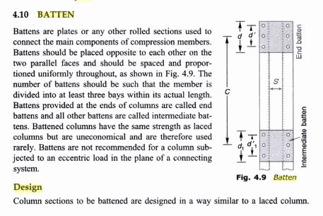

Can anyone direct me to the buckling equation for a plate loaded in shear that is simply supported on its two loaded (top & bottom) edges and free on its remaining (side) edges?

Yes, I'm sure. I'm lacing together two columns that are about 16" apart (clear distance between flanges) with batten plates on 3'-0" centers. The columns are fixed at the base and subject to both axial load and bending loads.

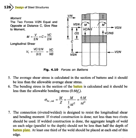

Quote (brockjd)
As I mentioned above, this will be a case where bending stress/buckling will be as, if not more important, than shear buckling. So, while I'm sadly unable to answer your specific theoretical question, we should certainly be able figure out something to allow design to proceed.
Most of the stuff that I've seen on battens and lacing has been prescriptive or semi prescriptive. The stuff below shows how they handle it in the Indian code. It strikes me as conceptually well thought out.
