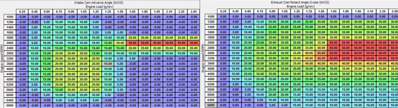

A 2013 Subaru Legacy 3.6 (H6) i'm tuning has dual VVT or Dual AVCS as subaru calls it. I can control both intake and exhaust timing (50*/40*) respectively. The cam specs seem to be very mild even though the car has no problem building torque up to 5200 RPM and power peaks at 6000 rpm at 260ps.

the stock VVT maps can be accessed in the ecu and are as follows. However PLEASE NOTE that the exhaust retard has been mistakenly named Intake Advance and vice versa.
stock AVCS tables
I noticed the intake AVCS tables have 50* of advance stock at low-mid RPMs. The exhaust has been retarded at about 20-30* at ~2000rpm.
Now from my readings I have found that Advancing the intake whilst retarding the exhaust actually increases overlap which results in poor performance and reversion. Advancing both intake and exhaust however should create low end torque. So why has subaru retarding the exhaust cams at low RPM while intake is fully advanced? So opening the intake further after BDC (more advance) and opening the exhaust valve sooner before TDC (advancing the exhaust) will definitely give more torque no questions asked.

1. The OEMs have put vast amounts of engineering into this.
2. The OEM's objective isn't always maximum possible performance - especially at low engine revs. In that operating region, the OEM's primary objective is emissions and the secondary one is fuel consumption.
3. The accelerator isn't always floored ... the driver does not always want maximum acceleration ... but having the throttle open enough so as to not have much intake vacuum even when the accelerator is not floored, artificially makes the engine have less output torque (the driver does not have the accelerator floored ...) but without much intake vacuum ... this results in a "wide open throttle but part load" setting that has (1) lower pumping losses, and (2) "internal EGR" for NOx control, than just shutting the throttle would achieve.
Retarded exhaust and advanced intake (= high overlap) but combined with a nearly-open throttle (so reversion isn't as much of an issue) sounds like a part-load-but-full-throttle optimization strategy for emissions and fuel consumption.

No ... It's good for efficiency (lower pumping losses by allowing the throttle to be opened more) and lower NOx emissions (from "internal EGR") when the requested torque output is less than maximum.
You will note that the greatest exhaust retard and intake advance (maximum overlap) are near 2000 rpm and higher engine load. With an automatic transmission (which is the usual case nowadays) this is not the operating condition when the driver has the pedal to the metal (max acceleration). This is the operating condition when driving on cruise control up a moderate hill. It will want to keep the transmission in top gear with the torque converter locked at cruise RPM (2000ish) while not burning too much fuel in the process and certainly while not emitting too much NOx. If the driver requests more power than can be delivered in that situation, the transmission will downshift.

2000 rpm isn't a target for such high overlap; it's a target for minimizing emissions and fuel consumption in that RPM range and the cam timing that they've chosen is a means of achieving that. They're likely sacrificing a few lb.ft of output torque BUT they are maintaining closed-loop operation (happy catalyst) for emissions compliance. At the OEM level the calibration in the common driving speed and load ranges is ALL about emissions, emissions, emissions.
If you need more power than 2000 rpm will deliver ... downshift! And if you are climbing a hill on cruise control and it is not able to maintain speed, that's exactly what will happen.
You could play around with whatever cam timing you want but it's highly likely that you will not be able to do appreciably better overall than the OEM setup. A lot of engineering hours and testing by a lot of people went into that calibration.

+45 intake and -5* exhaust retard gave best power at 2000 rpm vs +50 intake and -30* exhaust.
+35 intake and -5* exhaust best for peak torque area
+10 intake and -10* exhaust for best peak power (same as stock)

It isn't necessarily that "overlap is good for low end torque" but more that high overlap is an unavoidable consequence of using mechanical cam lobes with a fixed duration, and the bad side effects of that high overlap are less than the bad side effects of having a too-late intake valve closing and a too-early exhaust valve opening. Honda VTEC systems have VVT but they also switch over to a shorter-duration (and lower-lift) cam lobe at low revs in order to cut down on the excessive overlap in that speed and load range. BMW Valvetronic and Fiat MultiAir systems are capable of changing the intake duration period.
You will note that your VVT map moves towards less overlap at very low engine load ... because in that region, they have to start closing the throttle and having intake vacuum, which causes exhaust reversion, and then the bad side effect of high overlap is worse than late intake closure. All of this is why modern automotive engine designs have VVT!
