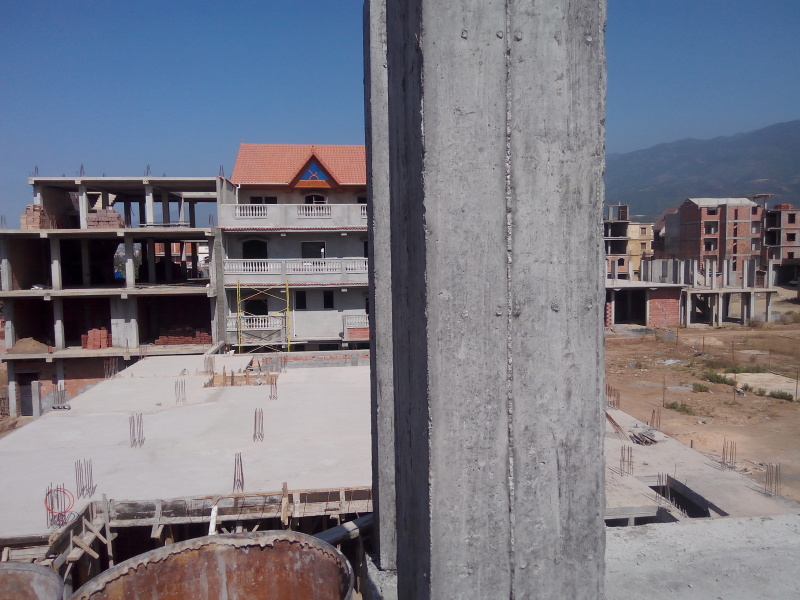

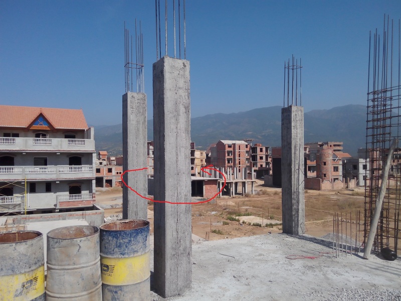

Hello
So i am building my house and one of the RC columns ended being rotated around its axis . Yes i am a civil engineer but not quiet sure if this defect can have any significant impact of the structural performance of the house , so please help me ?

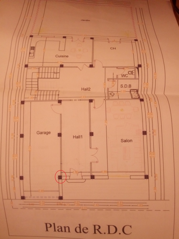

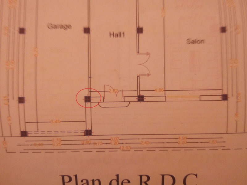

its a square column , i need to scan the plans which are basically in French
RE: Rotated concrete column
its the one inside the red circle , its a square column with dimensions 0.35²x 3 m

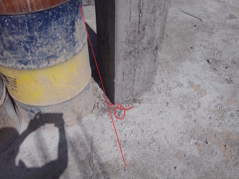

the column was recently constructed , i noticed the steel reinforcement cage was rotated it self i will provide a picture of its tomorrow

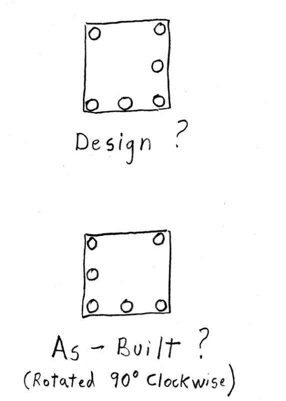

So you have a 350 x 350 square column, 3000 high. Correct? And the problem is that the reinforcement is twisted so that you have reduced cover at the corners of the reinforcing cage. Correct? How much cover was specified and how much do you have?
Hokie, I understand it as the reinforcing was rotated a full 90 degrees. Which may or may not be an issue depending on whether it's part of a lateral frame or not.

Your angle of rotation will likely have little effect on the structural capacity of the column; however, it does create a constructability issue with framing and trim. Make sure they correct that for the final finish by shimming or other means to box the columns in the same manner.

thanks to all of you, yes i aware that it has no impact on the structural stability yet it all boils down to the final finish and just wanted to know if we can rescue it in the end
The finish carpenters are pretty good at hiding mistakes. If you make them aware of the issue they should be able to come up with some form of repair. What are the plans for finishing the columns?
No structural implications. It looks like your joinery will at least partially conceal two sides, and maybe you can get a plasterer to true up the other sides. Or just keep it that way as a conversation piece.
