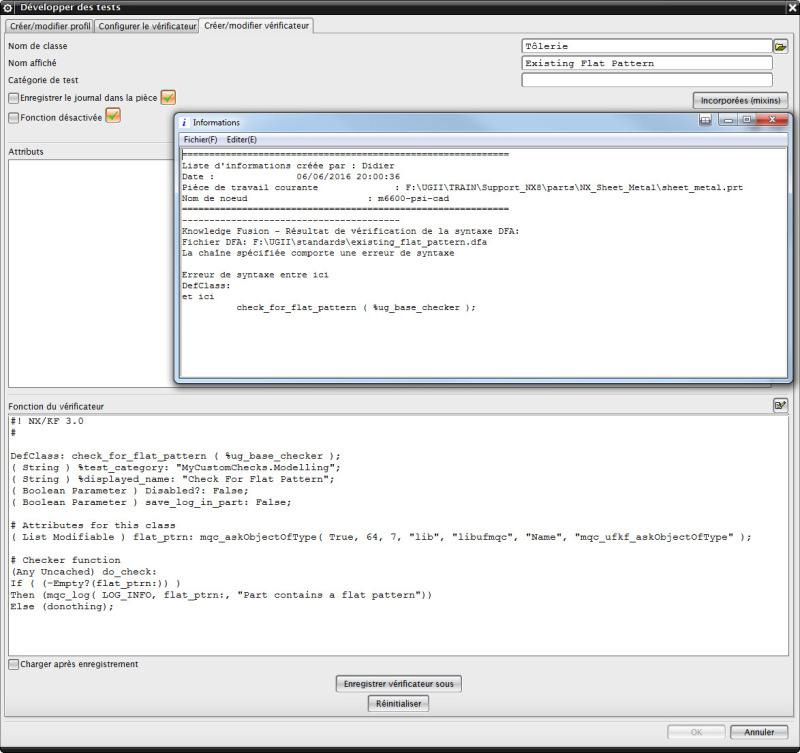

RE: Using ug_inspect to check if flat pattern entity exist in a part
Hi NXJockey,
Thanks for your help, but I have the following error message:
Regards
Didier Psaltopoulos
http://www.psi-cad.fr
Hi, try just putting the dfa file in your checkmate directory
Cheers,
NXJockey

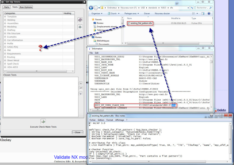

Hi NXJockey,
I have set up my own dfa directory, but where is my test ?
Thanks in advance
Regards
Didier Psaltopoulos
The checkmate directory is listed in the ugii_env.dat. It's this dir which controls the checkmate profiles
Cheers
NXJockey
With regderence to the above, a simple way to set up the abouve checker is as follows.
1.) CREATE A FOLDER CALLED 'checkmate'
2.) CREATE A SUB FOLDER WITHIN THE CHECKMATE FOLDER CALLED 'DFA'
3.) STORE THE FILE IN THE DFA FOLDER
4.) CREATE A LOCAL ENVIROMENT VARIABLE:-
UGCHECKMATE_USER_DIR=**** YOUR PATH TO THE FOLDER ****\checkmate\DFA
5.) START NX
Cheers,
NXJockey
Hi NXJockey,
I was on another subject for few days and I come back to day to this one to thank you. I succeed.
Now I will start a new thread because the tittle of this one is not adapted.
