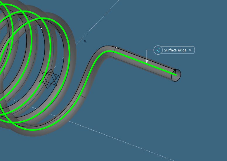

I am only interested to know if Catia has a feature that extract the centerline of this unparametric solid.
NX has a feature that can do this..................

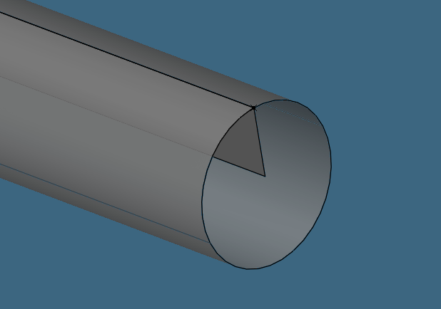

catia can't do it in one click (for the full solid) and it might actually be faster to read some measurements and build a new curve.
if you want to go the long way: create a point on the planar end face and then create a isoparam curve on the surface along the geometry then a sweep on that isoparam at 90deg to the surface, then length of the sweep should be equal to the radius.
then extract the boundary of the sweep:

Thanks a lot, that's what I needed.......!
Thanks for your time, Itsmyjob!
