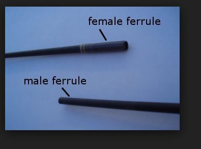

Fishing Pole - I win!

Distraction force separates fishing poles violates 5. Rigid when coupled in all planes of motion

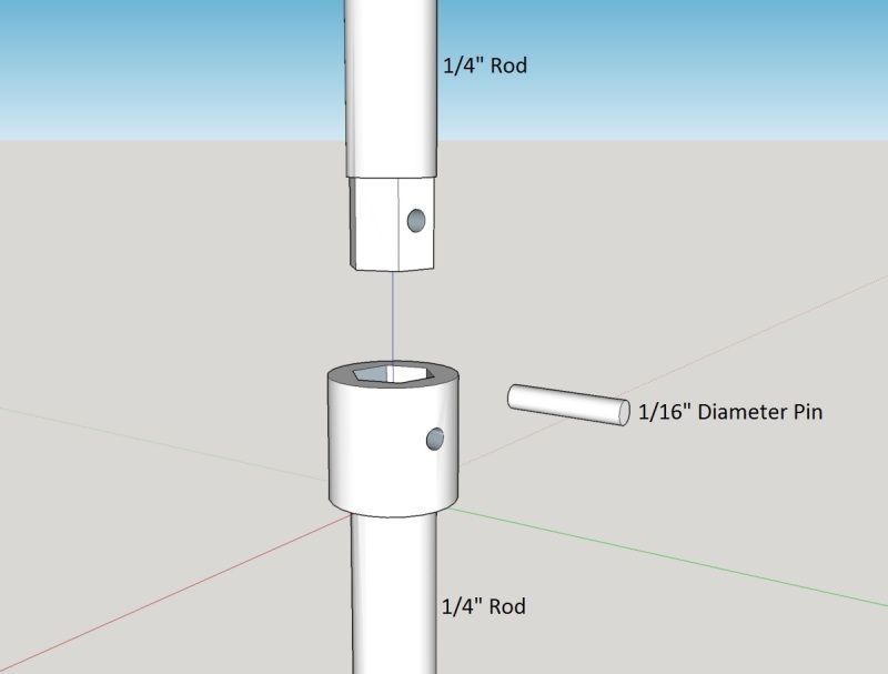

2. Hand operated Quick connect/disconnect
The attached picture is a proposal I made in CAD - however drilling a 1/16" hole in the rod compromises its strength and for the pin to hold in place hand operation may be difficult (may need a lot of friction on the pin and require a pin punch tool)
One step closer,

Re: Your interactions with Mike Halloran, You may be right that leaving things very open ended gives you a better brainstorming result, but unfortunately, you're not paying anyone here for their time to brainstorm. This website has some of the most experienced/talented engineers I've ever interacted with, but they don't have the time or inclination to throw ideas out for you for an hour straight in the hopes that one of them randomly suits the project you haven't fully disclosed to them. Ironically, if you were paying the people here for their time, you would probably give them full disclosure ASAP so you wouldn't have to pay for said hours of throwing random ideas out.
With your hex joint and pin, either the pin shears off or you get failure from the bearing stresses when it goes into tension.

The "phishing" pole idea by jon286 is the right path. With the radial stress distributed throughout the whole taper and perhaps a "thru" as an additional measure you have basically all the elements required in the post.

OP feels A 1/16 inch pin in double shear is " near equivalent strength to 1/4" steel rod itself ." in tension ?

The best solution seems to be your original idea, 'cept i'd do it with three pins (matching the hex. shape suggested). Mind you a hex profile fitting within a 3/8" diameter with a 1/4" bore doesn't provide much thickness in the coulping.
I assume you can't thicken the rod locally, so that if you cut both sides to be mating semi-circles (or mating 1/2s) and pin them together.
unfortunately all these ideas fail to retain the pins in any acceptable manner.

MadMango, your drawing shows promise, but it has two flaws:
1. The typical E-ring will not meet the diameter requirement.
2. Because the E-ring has three teeth and three gaps, the assembly can be disassembled axially if the E-ring is aligned rotationally with either set of jaws. If each rod had two jaws instead of three, it would sort of work, but probably be a little wobbly.
Perhaps it could be improved by threading the OD of the rod ends instead of grooving them.
One rod threaded a little more than the length of the jaws, and equipped with an upset shoulder at the proximal end of the thread.
The other rod threaded for a little more than twice that distance, allowing withdrawal of:
A sleeve, threaded internally, knurled externally, length roughly equal to the jaw lengths.
Spin the sleeve away from the jaws to allow disengagement.
Spin the sleeve over the jaws and tighten it against the shoulder to secure the joint.
I might further enhance the joint, getting rid of the sharp corners, by giving the jaws roughly the same shape as the finger joint used in woodwork. ... and maybe reduce the number of jaws, perhaps as far as two jaws on one rod and a complementary tongue on the other, again with the finger joint profile. ... given that, the central pin and socket may not be required.

I wasn't trying to engineer the OP's solution, only offering a suggestion. A snap ring would be better than the e-clip shown, and sharp corners should be removed to reduce stresses. The 3-lug features could be made with rotary broaching or standard CNC.

Seems there may be a US/rest of the world naming discrepancy related to the infamous cotter pin confusion.
This is what I'm talking about.

I question the requirement of no tool being needed. It's really not inconvenient or risky if it's integrated into the overall product, like a drill chuck key on some portable or cordless drill motors.
Overall, I'm a big fan of rigid mechanical couplers like @MadMango modeled in the post a few spaces up. It's a semi-common strategy for such situations. When you /do/ want flex in the line, then I'd design something akin to your average automotive universal joint, so long as the angle of flexure isn't great. Without the flex though, you minimize clearance between mating lugs/fingers and come up with whatever manner of retention is practical. Using a 4-lug mate would be easier to make, but less rigid than the tri-lug coupler @MadMango suggests.
I believe that's generally the wisest approach, until someone else comes up with something better ;)
