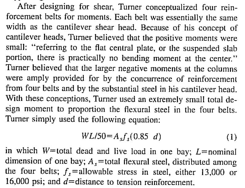

Some of the very early (like 1905) flat slab systems (C.A.P. Turner, for example), before these slabs were codified, had significant issues:

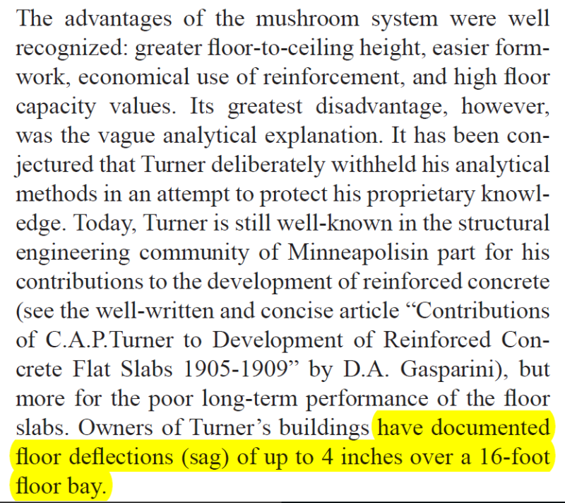

With resulting deflections:

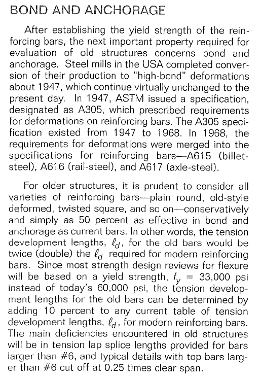

Since your flat slab was constructed after the 1950's it is probably okay, but worth checking bond and anchorage, especially if justifying the as-built capacity based upon USD, for an original design by WSD.
From CRSI Engineering Data Report #48 'Evaluation of Reinforcing Bars in Old Reinforced concrete Structures'

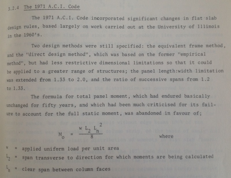

By way of follow up with regards to my post above re ACI-318 1971 and the total static moment. I checked one of my old references, and the 1963 code was the last issue where less than 100% of statics was code permissible.
From: THE DESIGN OF FLAT SLAB STRUCUTRES - AN HISTORICAL SURVEY by K.A. Faulkes:
