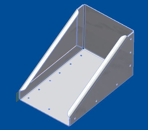

Hello all,
I am done with the 1st half of my BSME so I have touched on this type of thing but as for the actual application I am having trouble. I am trying to design a bracket to hold a small (110 lb) outboard motor on the back of my boat. Right now I have it modeled with .125'' thk 6061-T6 mostly because we have a large sheet of it at my work I can use for free, but I want to make sure it will hold up. I want to figure out what forces will be acting on the bracket as the motor bounces around while going over waves or while on the trailer.
Thanks in advance for your help!

One thing to know is that it is better to start off with an arrangement drawing - showing the relative positions of the boat, the motor, and a rough idea of what the bracket will be like. Then you can add the masses and forces that are expected. Then come the reaction loads, and from the reaction loads the final structure can be started.
As it is, what you are looking at is making an estimate of how long the bracket will last and what effect its deformation will have on performance. And that's going into fatigue analysis, which requires a lot more than can be covered here.

I don't have a specific design tip, but my gut reaction (tempered by 40 years of doing this stuff) is that 1/8" aluminum and a 110 lb boat motor will not go together well. Even if all the formulas tell you it will work and even if it appears to be steady and secure on dry land in your shop, it is very easy for me to see it cracking, fracturing, and sinking to the bottom in use. Bye bye motor.
This is like one of those tests in school where the prof gives you all this extraneous information intentionally to lead down the garden path to an incorrect answer. In my opinion the actual stationary weight of the motor is among the least important factors. The main forces (and resulting damage) will come from the forces and vibration generated by the motor and by the boat as it encounters waves.
My suggestion? Ignore that sheet of 1/8" aluminum in your shop. Use it for a cover or decoration if you like. Widen your scope to find much heavier material, much heavier. That will probably also mean you can't fabricate it as a sheet metal component (with bends and flanges). You're probably looking at a weldment.

RE: How to calculate forces from an object bouncing
i'd worry about the bending loads going into the flat plate attaching this to "the rest of the world".
build one, bolt it down, wack on it (in a carefully controlled way), see what it does ... return to step 1 if required.
if you've got 6061T6 for free, use it ! (but be aware of the 3t bend radius required).

Thanks for the input everyone. The boat is a 21ft fiberglass cuddy cruiser with an I/O so there is nowhere to mount this motor. It weights around 4000# so the 15 hp "kicker" won't move it fast, it is for trolling so I dont have to run the V8 all day and it'll also be used as a backup in case the my main has issues. Like stated above my primary concerns are hitting waves when running with the main and while riding on the trailer. I generally cruise between 25 and 30 mph depending on seas.
Initially I was planning to mount it to the swim platform as it supports my weight fine but then I thought about it more and gave consideration that the motor will be on it 24/7. Now I am leaning towards just cutting the swim platform and making a mount that bolts to the fiberglass transom with a backer plate on the other side of the glass.
From the comments above it looks like I should look into a weldment. Maybe use 2X 1/2" thk 6061 plates, one to mount to the boat and one to hold the motor and then buy a square tube to span the gap between them and have it welded. I can buy a 1' section of 6" x 4" x .25" wall 6061-T6 tube for around $40.
It seems as though any calculations I do wont be accurate so I wont rely on them. My first two years have been more generals than engineering classes, although I have taken statics and dynamics we didn't cover fatigue. I think I could figure out how much force it would take in one shot to make something fail but I don't expect there to be enough force from 1 bump in the road to break my mount/boat so that leads me to fatigue and how to factor that into my analysis.
drawoh, I would have to disagree with your comment. Most fabrication is not done with 5052. The company I work for does fabrication primarily in the aerospace and we hardly ever do anything from 5052, and never anything structural. If the part needs a tighter bend radius than the material allows we either start with O and then heat treat to the desired temper or bring it to W, form and let the parts age harden.
Thanks to everyone for your comments. Although I am not much further along in figuring out how to do a failure analysis for this problem (which I understand was vauge especially not knowing where I am in my own knowledge) I feel more confident in the bracket. This was my 1st post on this forum and I am surprised by the helpful feedback. Hopefully someday I can contribute.

This kind of job should be solved with "stiffness" rather than "strength". What I mean is that you should be looking at thick sections and stiff components; once you do that, the strength you need will follow.
