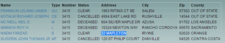

Using the "License Lookup" feature on the California PE Board website, it is clear the license number is comprised only of digits. The "C" or "S" letter refers to the "type" of license (civil, structural, etc.). Perhaps it is permissible to include the letter on your stamp but I don't believe it is necessary.

If you look up a particular license number on the CA lookup thingy, you may well get more than one registrant. Does that mean that the letter designation is legally required? Nope. Does it mean that, independent of a name, you'd require the letter designation to uniquely identify a particular registrant. Yup. Although, for the sake of the actual stamps, however, listing "Branch" would surely alleviate any confusion.
