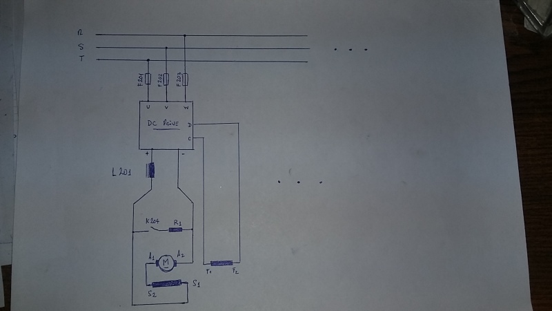

There are no snubbers and no input reactor installed
Please see the schematic drawing I made.
L201 output reactor 18,5 mH
R1 Brake resistor for emergency stop
K204 Emergency stop contact
F201, F202, F203 input fuses
All 9 Drives are feed the same way from R-S-T Bar but only Block 4 keeps failing
Can loose terminals on fuses connection be causing the fault? I am not saying we found that, just asking
What about a mistiming between K204 and Drive Disable operation?
Skogsgurra: Are you meaning to arcing on motor commutator? We have checked this many times while in operation. There is not abnormal arcing
RE: SCR faults on DC Drive
Bad or damaged contacts on K204?.
Chuck
My first thought also. Take a good look K204, R1 and all the associated wiring and connections.

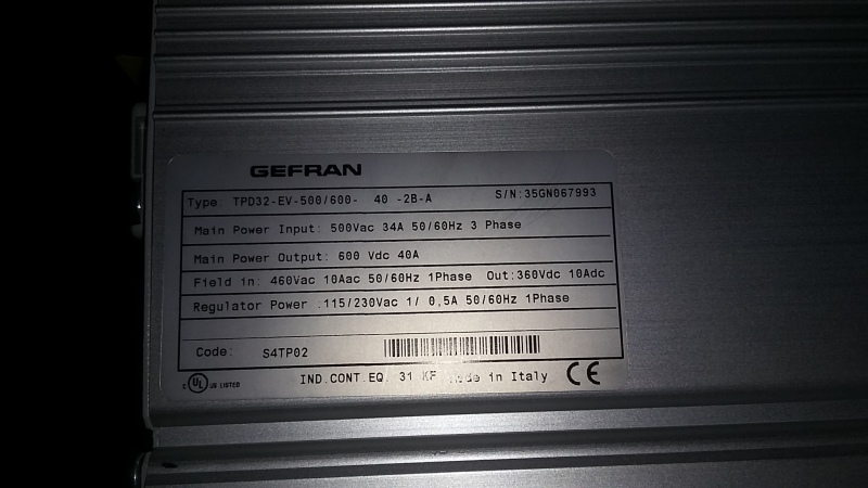

Hello lukin1977
What make and model is that Drive?

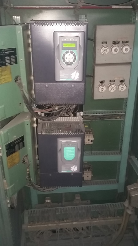

Please investigate also the cabinet temp of block 4. If you have 9 of them, no. 4 should be in the middle of a row! Just a hunch though.

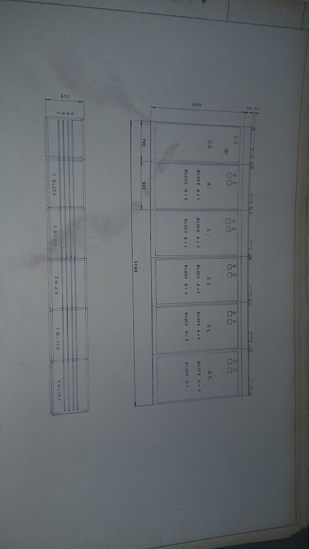

The 9 drives are installed in pairs inside individual fan ventilated cabinets
1st cabinet: Command circuit and logic components
2nd: blocks 1 and 2
3rd: block 3 and 4
4th: block 5 and 6
5th: block 7 and 8
6th: block 9
Non of the 9 drives have input reactors installed. They only have one reactor at the output side. L201

Mains voltage is 3x380V
I have the DC Drive TPD32 EV Instruction Manual and this is what I found:

You can also opt to put in one larger reactor for each pair of drives if there is a single feed to them, that might make it easier. Same inductance, but sized for the total current of both motors.
Another thing that might be happening here is relating to that K204 contactor again. Your sketch doesn't show the control circuit, but assuming that contactor is controlled by an output of the drive, and assuming you tapped L-N for 230V control power, it would be IMPERATIVE for the coil of that contactor to have surge suppression. It could be that in all of your cabinets, the contactor coils did have surge suppression installed initially, but on this particular unit it has burned out, allowing a spike to get back onto the AC line every time that contactor changes state. Distance of the circuit may be preventing that spike from causing self commutation in any adjacent drives, but because it is right there on #4, it affects only that one and because you likely left that contactor in place when you swapped out the drive, you killed the replacement eventually too.

yes, control circuit is 220V
I will try to explain the logic of the ES (emergency stop) control circuit
On each wire drawing block there are emergency push bottoms that are series connected. When one of them is pushed it closes a relay in cabinet Nº1 (relay GA.K11). This relay close a contact that goes to all of the rest of the cabinets. ES signal
On each cabinet there is another ES relay (A.K1) that opens drive´s enable signal and closes K204 (brake resistor contactor)
Normal operation:
There is a ramp generator card on cabinet 1 that feed all the rest. When start bottom is pushed the drives are enabled and ramp goes up. When stop is pushed ramp goes down and enable signal is cut off BUT there is an programable relay contact on each drive (Relay 2) that is used to keep each drive enable until speed gets down to a certain low value (speed zero level)
I been taking to machine operator and he told me that he never uses the ES while at full speed but he uses to stop the machine while he is in threading stage (this is when the wire is pulled from block to block until 9th at low speed) because is easy for him to push the ES than the normal stop bottom. So on each day ES may be pushed many times
I think this relay 2 is causing the K204 to close while drive is still enable. This is what I was referring to on 2 Jun 16 14:53 when I said: mistiming between K204 and Drive Disable operation
Will have to check the speed zero level on relay 2 on drive #4. They are not the same on every block due to different speed reducer gears
Also checked for surge suppressors and there are none. Will have to install them too
