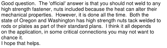

Often, we use a double nut and washer assembly for anchor rods (nut/washer/nut). If the weld occurs on the top of the upper nut, where the rod is still carrying its full tension load, then I believe that you're subject to localized embrittlement issues similar to what we deal with when welding rebar. Different steels are susceptible to varying degrees of course.

KootK....that's a good point; however, most anchor bolts are relatively mild steel and weldable. If for some reason you are using a steel that is subject to embrittlement then I would be cautious of welding or even tack welding.
See attached sketch for illustration.....

This is a response that I got from Portland bolt in 2010 supporting the notion that nut welding is no big deal.
RE: "J" anchor bolt vs headed anchor
KootK....yes! Well stated from Portland Bolt. ps....they are a wealth of techy info!
