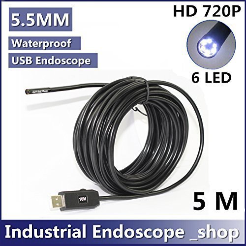

In 2015 I purchased a very INexpensive endoscope to trial some video/photo inside unbonded PT sheaths (after the strand was removed).
I purchased a $20 one from Amazon. Link
It has a 15' cable with USB that connects to your computer and uses the Windows video/photo software to capture the images. The endoscope has 6 small LED's that are brightness adjustable. The diameter the camera head is about 6mm.

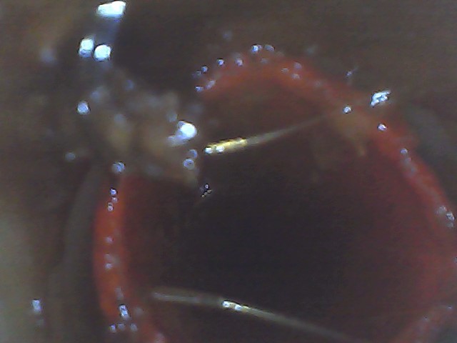

Here is an image inside the stressing-end anchorage of the tendon, about 12" inside the transition sleeve. The RED circular object is the PT HDPE sheath of about 1/2" ID. The hazy substance is grease. The image quality was as good as I expected for $20!
I attached the cable/head to a small 3mm dia steel wire to have control on the camera direction/location.
