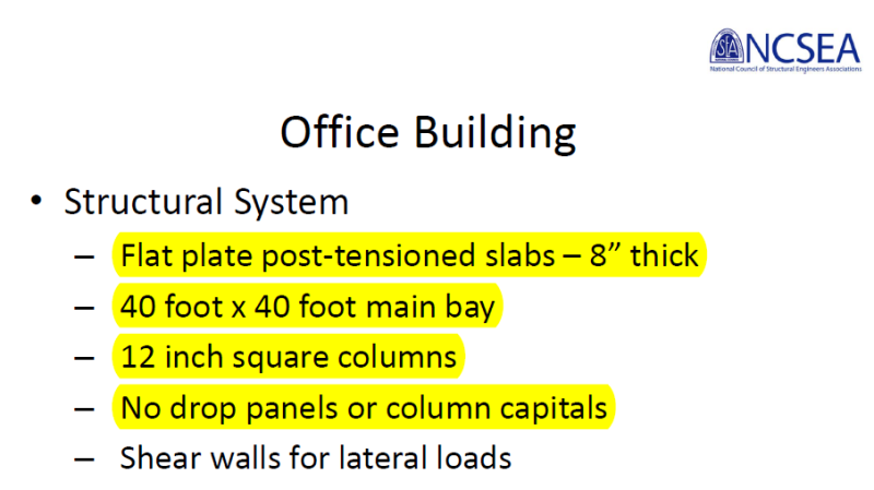

Yesterday I attended a pre-recordered webinar by our local SEA on ACI 562: CONCRETE REPAIR CODE presented by Dr. Keith Kesner and one of the three (albeit brief) case studies presented was an office building as follows:
After a few minutes of 'googling' I identified the building and its location, but I won't share it here.
5 floor levels, repetitive, simple, rectangular plan layout. What was the EoR thinking?
  • Span-to-depth (L/D) of 60!
  • 12" square columns for a 5 level building
  • No drop panels, caps.
The building was constructed in early 2000's, was in service for approx 10 years, and after multiple investigations/reports, it was deemed unsafe and closed by the building official.
It was repaired/strengthened at a cost of more than $20M (there were building envelope, plaza deck and other issues too). Obviously there were lawyers and insurance companies involved and the EoR settled.

It appears that the information provided in the case study at the webinar is in conflict with this:
Quote (Investigation Report)
The building's floors are formed by 10-inch post-tensioned flat plate elevated floor slabs that are supported by reinforced concrete columns and walls. In the office building, the 10-inch floor slabs span 38 feet. Shortly after the property opened, cracking was reported in wall, ceiling, and floor finishes.
L/D still up there at > 45, but better than 60!

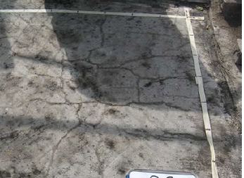

I found several reports of the building via some google-digging. Some very detailed reports in documentcloud.org, which I won't share to protect the guilty, but here is a brief summary pertaining to the PT slabs. There were also issues with the building envelope and facade too, related to the slabs design shortcomings:
1. P/A of 450 psi in many areas;
2. PT was balancing 200% of self weight in many shorter spans;
3. Measured midspan deflections of 4" in dominant long spans;
4. Punching shear demand/capacity ratios of 3+; See photo below! One reports mentioned that closed-tie 'shear heads' were used but I can not confirm this.
5. Axial shortening of +1-1/2";
6. In-situ concrete compressive strengths of less than 4,000 psi after 10 years;
7. Numerous construction-related defects too.
8. Lateral force resisting system was also undersigned.
Original construction cost was about $30M in 2000.

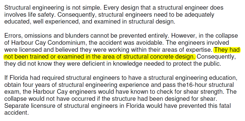

About 30 years ago, a similarly designed and constructed building in Brevard County, Florida was under construction. It was also a 5-story building. Failed from punching shear, along with errors in the height of the rebar chairs that were used and a variety of other design and construction issues. Building collapsed, pancaked the slabs, killing 11 people. The collapse led to the enactment of the Florida Threshold Building law and designation. After that, all buildings of a certain size and/or occupancy were required to be inspected by an authorized "Special Inspector" (not to be confused with the term "Special Inspector" under the International Building Code......different requirements). The project was the infamous (at least in Florida) Harbor Cay Condominium collapse.
My point is that such things happen all too often. My firm was involved in the investigation of the failure of a parking garage under construction in Jacksonville, Florida in December 2007. Underdesigned and marginal construction. One person died.
RE: Office building featured in case study of ACI 562 webinar by NCSEA
Ron,
I recall reading the NIST report some time back on the Harbour Cay collapse. I also remember reading in another reference to this collapse (Feld & Carper, 1997) that the structural engineer was a retired NASA engineer who hired another retired NASA engineer to perform the calculations and Prof Norbert Delatte made a point that:
Quote (Prof Norbert Delatte)
…structural engineering isn’t rocket science. Evidently, it is considerably more difficult
Reference: "Beyond Failure: Forensic Case Studies for Civil Engineers". ASCE Press, 2009,Delatte 2009, p. 153.
And this by Gene Corley:
Reference: CASE STUDY - Collapse of Harbour Cay Condominium" ASCE/SEI
Ingenuity....yes, the engineers were practicing outside their areas of expertise (obviously). Not that it helps much, but they lost their licenses, forever.
I'm not sure I completely agree with Corley. The SE does not guarantee that mistakes won't be made, though I do agree that the more rigorous the exam process, the lower the chance of missing one of the "fundamentals" of a design. I'm pretty sure that when that failure occurred, there was no SE licensure. I was hired by an attorney for the rebar producer to review the rebar shop drawings and compare to the design. Had just gotten started when the whole thing was settled.
