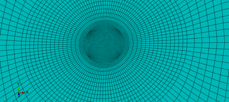

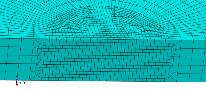

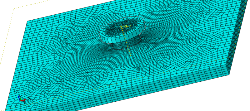

Hello everyone ! this is my first thread and hope that I get valuable suggestions from the experienced persons in this forum ! below is the description of my problem-
"I'm modeling a friction based welding process which involves a rigid tool being inserted into a deformable (Aluminium alloy) workpiece. I've used Johnson-cook plastic hardening with Johnson-cook rate dependency (initially it was the plasticity) to see if has some +ve effects on my model, but it didnt. I have used C3D8RT elements for both tool and workpiece.I've used a fine mesh for the interaction region (for tool and workpiece) and coarse mesh otherwise. The tool has an angular velocity of 400 rads/sec with a feed rate of 0.5 mm/sec whereas the bottom surfaces of workpiece are encastre'd. I've given the movement to the tool by using 'tabular' amplitude increasing in paced manner. In the step, i've specified non-linear geometry with mass scaling for the concerned interaction (tool & workpiece) region (factor-10^8) at the beginning of step (it does increase the stable time increment). I've used ALE adaptive meshing with a frequency of 1 and remshing sweeps as 50-75, I've chosen frequency of 1 so that I can specify ALE mesh constraint for the workpiece (only the region where tool is inserted). I even tried element deletion, although I didnt specify any damage criteria in material module (dont know if it's necessary). the total time period of my analysis is 4 seconds and a pressure of 80Mpa is applied on the tool. I would like to clarify that I've checked the units of the material properties 'n' number of times and there's no worry over there. Whenever i run the analysis, the model reaches a time period of only 0.86 seconds with stable time increment of 1.0E-6. the mesh gets excessively distorted and analysis is aborted.
I am attaching images of the meshed assembly and also models.
Please anyone who has knowledge about this issue or have faced same problem, give your suggestion/advise that can be used to resolve this issue. I've tried looking in literature of similar processes for a solution, but couldnt find any !
Thanks in advance !!

By the way if you ask my opinion and Based on my experience (I did not work with mass scaling and i can't say anything about that) answer below Questions:
1) Did you use Johnson-cook Damage ?
2) Did you use Damage evolution ?
3) What is your Element library ?
4) Can you take a Picture from model in 0.86 seconds, without Tool ?
5) Can you Write your Field Output Variables (In Step Module) ?
With Best regards.
yassou.

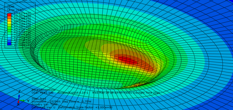

RE: ABAQUS/explicit (dynamic,temp-disp,explicit step) EXCESSIVE DISTORTION PROBLEM HELP
Firstly I would like to correct myself, the analysis stopped at 0.75 seconds and not at 0.86 seconds as I mentioned in the post (this value is from other model) and apologise for this. The answer to your questions are:
1. I haven't specified Johnson-Cook damage as I thought material in the model undergoes plastic deformation (although quite high) and isn't removed from the model unlike machining processes. Although, I've used Johnson-cook module in the 'plastic' definition of material property module.
2. I didn't use damage evolution either and can you point out where I can find it ?

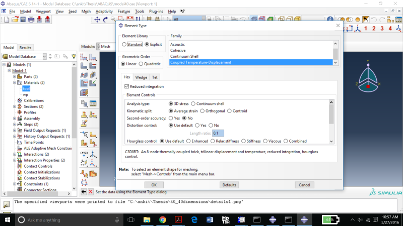

3. By element library, do you mean the type of elements I've utilized in meshing of the parts? If so, then I've used Hexahedral elements (C3D8RT) with default settings and used a structured mesh in the mesh controls. I'll post a pic of the specifications I've used. Below are the pics of element temperature,temperature (avg) and PEEQ results at step time of 0.7594 seconds.
pics of specifications of element:
I'm sorry but I didn't get what you mean by field output variables ? ( which variables should I provide info about ?)
Also, I would like to add that I have given interaction between the bottom surface of the tool and top surface of the workpiece and also between the side surfaces of the tool and the nodal region of the workpiece where interaction takes place. I've specified a value of 0.4 and 0.2 for co-eff. of friction for the two interactions respectively. Both of them are surface-to-surface interaction (explicit).
I've gone through the link and would like to mention that my units are consistent (mm-MPa-Tonne-K) and are from a reliable established source. In the other models which I've developed, I used low mass scaling factors but it didnt resolve the issue.

Try Below steps:
1) In Kinematic split, use Orthogonal.
2) In Distortion control, yes (0.1).

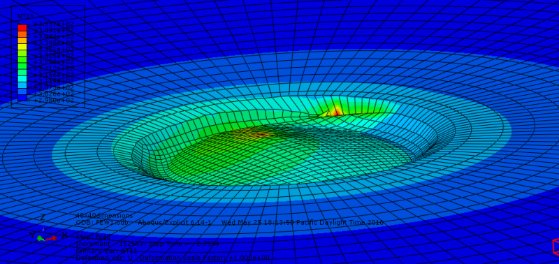

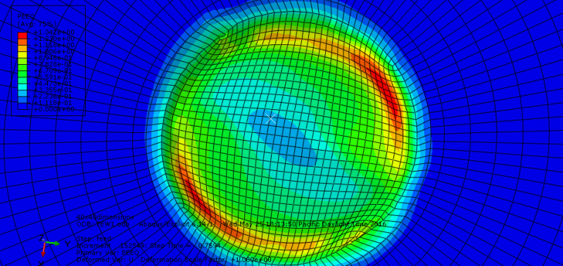

Looks like you have some hourglassing going on in there. Can you show a cross section view of the aluminum body? How many elements through the thickness?
I have never used adaptive meshing, but you may want to try a finer initial mesh in the problem area?

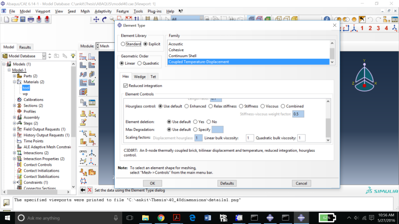

Dear Cooken,
I have used default Hourglass control as can be seen in the above pic, although I tried using 'enhanced' but there wasn't much difference in the analysis. Below are the pics of the meshed assembly, in the pic you can see that I've used sweep mesh controls (just trying out different things to see which one works out). I have used finer mesh in the region where interaction between tool and w/p takes place and have gradually increased the mesh size from there towards outside.
Try a section cut through the middle so you can see what it looks like through thickness at the refined area. Many of your elements probably have poor aspect ratios, and also if the 5 elements through thickness is constant all the way through, this may not be nearly enough where the large deformation is happening. Also check your energy balance, I would guess your artificial strain energy is quite high.

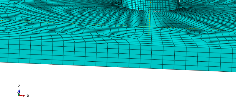

Dear Cooken,
As you can see in the pic, the density of mesh isn't 5 in the region where tool and wp interaction will take place, I've used quite a refined mesh in my earlier models but the result has been the same (distortion after some time). Can you please tell me more the checking of energy balance ? I'm not sure how it should be done. I'm attaching pics of the cut view of the concerned region.
Thanks.

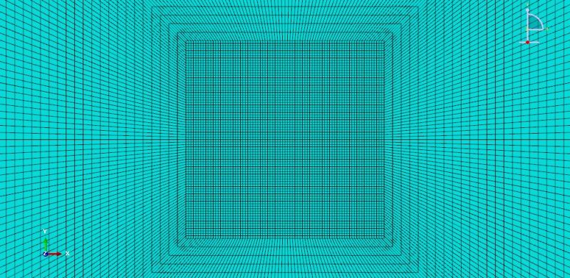

The elements in the region where you transition from 5 to 13 elements through the thickness of your part look poorly shaped. This is also the region where you see your highly distorted elements. I would take another look at the mesh - use biased seeds so that your element shape doesn't change abruptly over a single element length.
Good Luck,
Dave

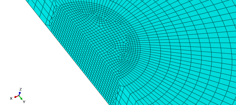

Dear Dave442,
Hello.
you're correct that I observe excessive distortion in the transition region. I'm not sure how I can give correct biased meshing, there are two types in it- single and double. Also, I'm not sure what does the direction of arrow means in it. Can you please help me out with it.
I am attaching my model's .inp file. I would appreciate it if you can go through it and give me feedback and/or make corrections in it.
Thanks.

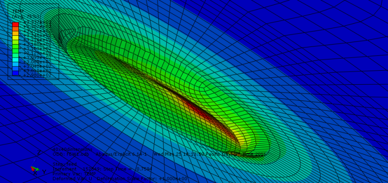

Your mesh is even worse now.
Look at the change in element size over the first three elements as you move from left to right on your second image. Also, lots of badly shaped elements in the contact/transition regions due to whatever way you have assigned the seeding. I suggested using biased seeding to remove the abrupt change in element size as you moved radially outward from the contact region. Not to re-mesh your contact region - as you have done. You want your element shape to be as close to a cube as possible. And the element size should increase gradually as you move from the central contact region through the transition region then more abruptly as you approach your part boundaries.
Good Luck,
Dave
Dear all,
@Dave422- I can understand my mesh isn't what you're suggesting, I'll make the corrections but as I'm relatively new (first time using ABAQUS) you can understand that some definitions in the documentation can be misinterpreted.
@IceBreakerSours-Regarding CEL, yes it's computationally expensive and is my last resort if the ALE formulation doesn't work.
@Yassou- Thank you for helping with the meshing, appreciate it a lot. However, when I open your .sat file by using import part option, the mesh isn't being generated, only the part is imported without the mesh. Should I import it in other manner ?

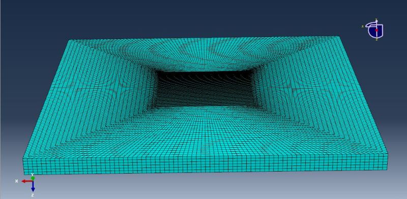

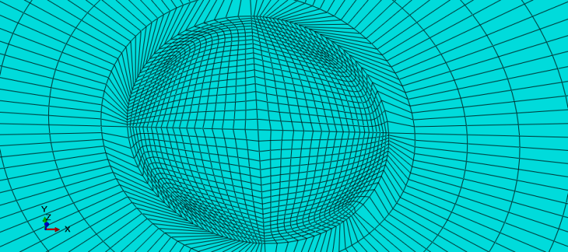

Dear Yassou,
Thank you for giving time to my problem and helping in resolving it. I followed steps as suggested by you, however, I had to make some modifications. I'm attaching pics of the meshed region.
I'm running the analysis and waiting for results. I haven't opted for a fine mesh as you had to reduce computation time.
MechDrive,
You are just repeating your mistake, this mesh looks even worse than your original one.
It looks like you have just made the fine mesh region extend to exactly the diameter of the rigid tool, or at most a couple of elements beyond, then you go directly to much bigger size and poorly shaped elements (see circled elem below). You need to have smaller, better shaped elements in areas of high strain gradient, which will be from the edge of the tool to probably 1.5 to 2 times the tool diameter. Look at your contour plots abaove - you need to have your fine mesh extend out to where it turns light blue, and transition to bigger elements from there to the dark blue region.
So you achieved a result...great. Is it meaningful? Looking at those plots I would say no. Your mesh is still bad, and can you not see the large amount of penetration? Why are the elements on the rigid tool smaller than the deformable ones??
Dear Cooken,
I never mentioned that these are the final results, I mentioned them as the results of a particular job in which the tool has gone the farthest so far. I too have noticed that the tool is penetrating the workpiece elements and therefore tried different shape of the tool. But the analysis couldn't run for much time due to mesh distortion and as such I've shifted to CEL approach, although I'm finding it to be computationally very expensive even for a coarse meshed model.
Thanks.
